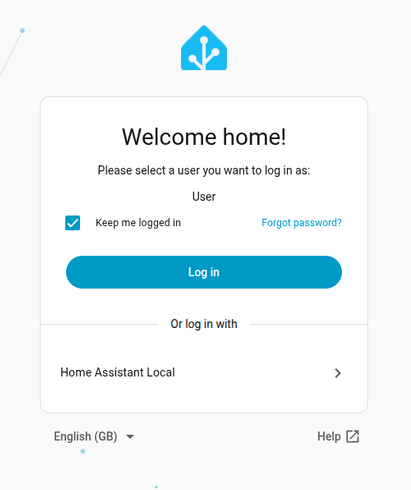

The best I was able to achieve was to reach the login screen, but you still have to press Log In button:
edit: I connected to the device via VNC and actually that Log in button doesn’t even work. I click it and it doesn’t log in.
And you have only one user available to select?
Ahh I figured out what the issue is. I had an incorrect user id set.
Your post helped me look at it closely.
Thanks!
