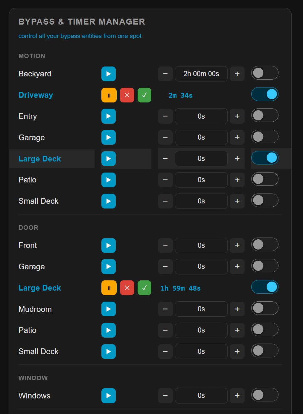

A Home Assistant Lovelace card that automatically discovers your bypass input_boolean and timer entities, pairs them by matching Entity ID Suffix or Label, groups them by type, and gives you full timer control — all with a built-in visual editor and zero manual entity lists.
Features
  • Zero-config auto-discovery — scans all entities at runtime, no YAML lists needed
  • Two discovery modes — match entities by ID prefix or by HA label
  • Automatic pairing — matches each input_boolean with its timer by identical suffix
  • Smart grouping — rows sorted into Motion / Door / Window / Light / Other sections automatically, with support for custom groups
  • Full timer control — Start, Pause, Resume, Cancel, Finish; editable duration input; live countdown; +/− step buttons
  • Last Changed row — optional second line per entity showing relative time since last switch/timer change
  • Built-in visual editor — configure everything in the Lovelace UI without touching YAML
  • Deep appearance customization — per-element font sizes and colors, secondary info line, theme-aware defaults
  • Display name cleaning — strips prefix, group keywords, and custom words automatically

Quick Start
type: custom:bypass-manager-card
That’s it — entities are discovered and displayed automatically.

Entity Grouping
Entities are automatically sorted into sections based on keywords in the entity suffix:
Keyword in suffix Section
motion Motion
door Door
window Window
light Light
(none of above) Other
