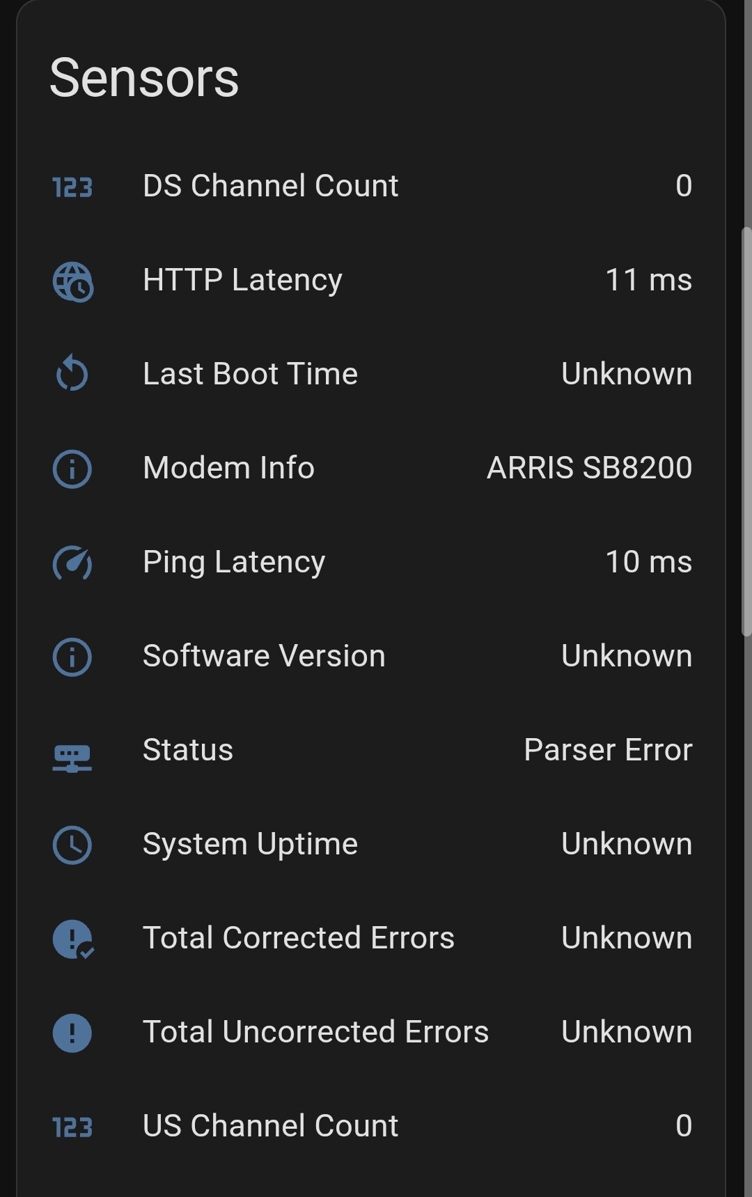

I have a SB8200 and would be happy to help you with any information you need.
Arris SB8200 HW Rev 7
Standard Specification Compliant Docsis 3.1
Hardware Version 7
Software Version AB01.02.053_082120_193.0A.NSH
I have looked through the logs and included the log here.
This error originated from a custom integration.

The newest release will access my cable modem now but I am still getting a parser error but it is pinging the modem.
The prior version failed completely.

@dtbelz Glad the latest release got past the connection error. The SB8200 has turned out to have several firmware variants — we have the original AB01.01 covered (#42, #81) and a
completely different AC01 variant tracked in #109. Your AB01.02 firmware on HW Rev 7 looks like it could be a middle revision we haven’t seen yet.
Could you do three things?
  1. Open a Sign in to GitHub · GitHub using the Modem Request template — that’s where I track all the details
  2. Grab your HA error log (Settings → System → Logs, filter for cable_modem_monitor) and paste it in the issue
  3. Run a HAR capture using the har-capture utility and attach the sanitized file to the issue — this lets me see exactly what your modem is serving
Instructions for har-capture are in the issue template. If you run into any trouble I can walk you through it.
