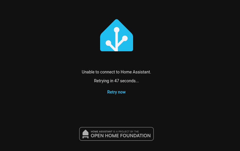

that geoblock call works for all my other self hosted services (jellyfin, qbit, nextcloud) but when i enable it for HA i get no information in my logs and a screen i havent seen before
and my (HA Core) logs say:
There are no new issues!
is there a header i am supposed to be forwarding to HA, i added all the ones i could find in an effort to solve this problem?
