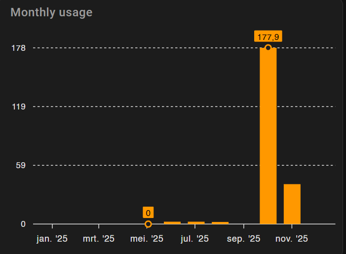

I think it is best to descibe my question by an example:
type: custom:apexcharts-card
apex_config:
  chart:
    height: 300px
graph_span: 1year
locale: nl
span:
  start: year
show:
  last_updated: false
header:
  show: true
  show_states: false
  colorize_states: true
  title: Monthly usage
  floating: false
yaxis:
  - min: 0
    max: ~15
    decimals: 0
    apex_config:
      tickAmount: 3
series:
  - entity: sensor.honda_energy
    show:
      header_color_threshold: true
      extremas: true
    type: column
    statistics:
      period: month
      align: start
      type: state
    group_by:
      duration: 1Month
      start_with_last: true
      func: diff
This is given me a nice graph of monthly energy usage.
What I also want is the total costs per month. Is there an option to calculate the outcome based on a static price and the same kWh results?
I do not have history of calculated prices I can use (only the used energy). It would be nice to solve this by just adding a simple calculation of kWh (monthly) * € (fixed cost for every month).
Cannot get my vinger arround how to get this to work.
Thanks
