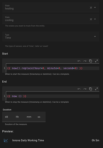

Setting up the helper was straight forward. It just didn’t know the different states the above made sensor can have but these can be inserted manually. In my case “cooling” and “heating”.
Next up I just had to define the start: {{ now().replace(hour=0, minute=0, second=0) }}
And the end: {{ now() }}
Now I get a daily total in hours of when my airco actually has been cooling or heating.

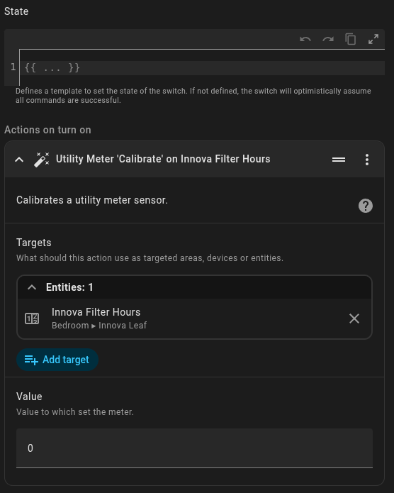

I created a 4th helper, this time a “Template → Switch”.
I added in the Action that when it is turned on, it calibrates the “Utility Meter” helper and sets its value to “0”. This restarts the integration and starts a new cycle.

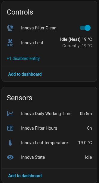

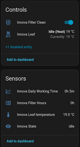

Problem 6: Make the automation trigger the switch and send a notification
Finally the easiest part, a small automation that triggers when the numeric state of the “Utility Meter” helper goes above a certain threshold. It turns the defined switch to the off position and sends me a notification to clean the filter. As soon as the filter has been cleaned I just toggle the switch back on and the counter resets to “0”.
This was way more work than I originally anticipated and I had to solve multiple problems. But I am happy with the end result:
