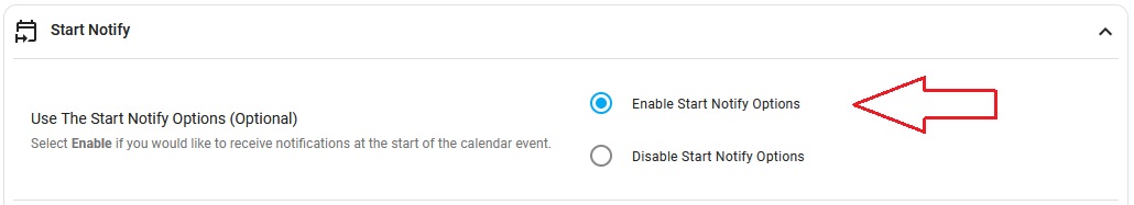

@hairyfred
Thanks for your YAML. You just need to enable the start notify option. See below.
Blacky :grinning:

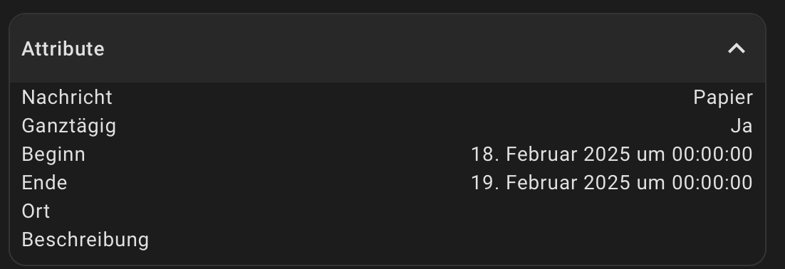

My calendar item for tomorrow in CalDAV:
Do you have any Idea what I could try?
@MS27HA
Thanks for your YAML. I have tested it here and it works for the start and end.
It will be in your offsets. You have -9 for the start and the end.
Event Details:
This appears to be an all-day event on February 18, 2025.
Start Offset Calculation
The event starts at February 18, 2025, 00:00:00 (midnight).
Applying a -9 hour offset:
12 AM → 11 PM (-1)
10 PM (-2)
9 PM (-3)
8 PM (-4)
7 PM (-5)
6 PM (-6)
5 PM (-7)
4 PM (-8)
3 PM (-9)
Result: The start trigger and notification will be at 3 PM on February 17, 2025.
End Offset Calculation
The event ends at February 19, 2025, 00:00:00 (midnight).
Applying the same -9 hour offset:
12 AM → 11 PM (-1)
10 PM (-2)
9 PM (-3)
8 PM (-4)
7 PM (-5)
6 PM (-6)
5 PM (-7)
4 PM (-8)
3 PM (-9)
Result: The end trigger and notification will be at 3 PM on February 18, 2025.
Testing a Start Trigger at 3 PM on Event Day
If you want the start trigger at 3 PM on February 18, 2025, you need a +15 hour offset from midnight:
12 AM → 1 AM (+1)
2 AM (+2)
3 AM (+3)
4 AM (+4)
5 AM (+5)
6 AM (+6)
7 AM (+7)
8 AM (+8)
9 AM (+9)
10 AM (+10)
11 AM (+11)
12 PM (+12)
1 PM (+13)
2 PM (+14)
3 PM (+15)
So, you would use +15 as your offset for a 3 PM start on February 18.
Hope this helps!
Blacky :grinning:
