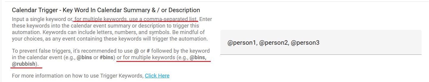

Actually it would be great if you could do multiple key words like @person1 ; @person2 ; @person3 …is it possible? Doesn’t work for me.
@wube
You are using a semicolon with a space. You must use a comma like this
@person1, @person2, @person3
This example is shown in the keyword input.
Hope this helps you.
Blacky :grinning:

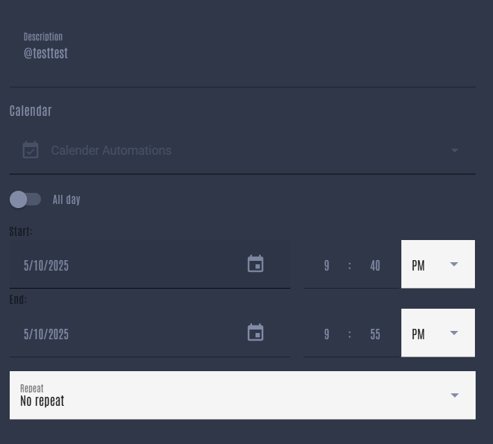

@Blacky this doesnt work at all for me. i get an error when trying.
alias: testcal
description: ""
use_blueprint:
  path: Blackshome/calendar-notifications-and-actions.yaml
  input:
    calendar: calendar.calender_automations
    calendar_trigger: "@testtest"
    include_start_auto_actions:
      - enable_start_action_1
    start_action_1:
      - action: conversation.process
        metadata: {}
          agent_id: conversation.llama3_2
          text: >-
            testing testing
        response_variable: response
      - action: assist_satellite.announce
        metadata: {}
          message: "{{ response.response.speech.plain.speech }}"
          preannounce: false
          entity_id: assist_satellite.voice_pe_assist_satellite
Logger: homeassistant.helpers.template
Source: helpers/template.py:2947
First occurred: 9:07:51 PM (2 occurrences)
Last logged: 9:40:00 PM
  • Template variable error: ‘dict object’ has no attribute ‘calendar_event’ when rendering ‘{{ trigger.calendar_event.summary }}’
  • Template variable error: ‘response’ is undefined when rendering ‘{{ response.response.speech.plain.speech }}’
@RogerB1
Did you wait 15min after you added your calendar event?
Looks like you have a problem in your custom action. I not a guru on the actions you have but maybe try this
"{{ response.speech.plain.speech }}"
or
"{{ response.speech.plain.speech if response.speech.plain.speech is defined else 'No response available.' }}"
or
"{{ response.response.speech.plain.speech if response.response.speech.plain.speech is defined else 'No response available.' }}"
or
        metadata: {}
          text: >-
            testing testing
        response_variable: responsellama3_2
        metadata: {}
          message: "{{ responsellama3_2.response.speech.plain.speech }}"
          preannounce: false
Blacky :grinning:
