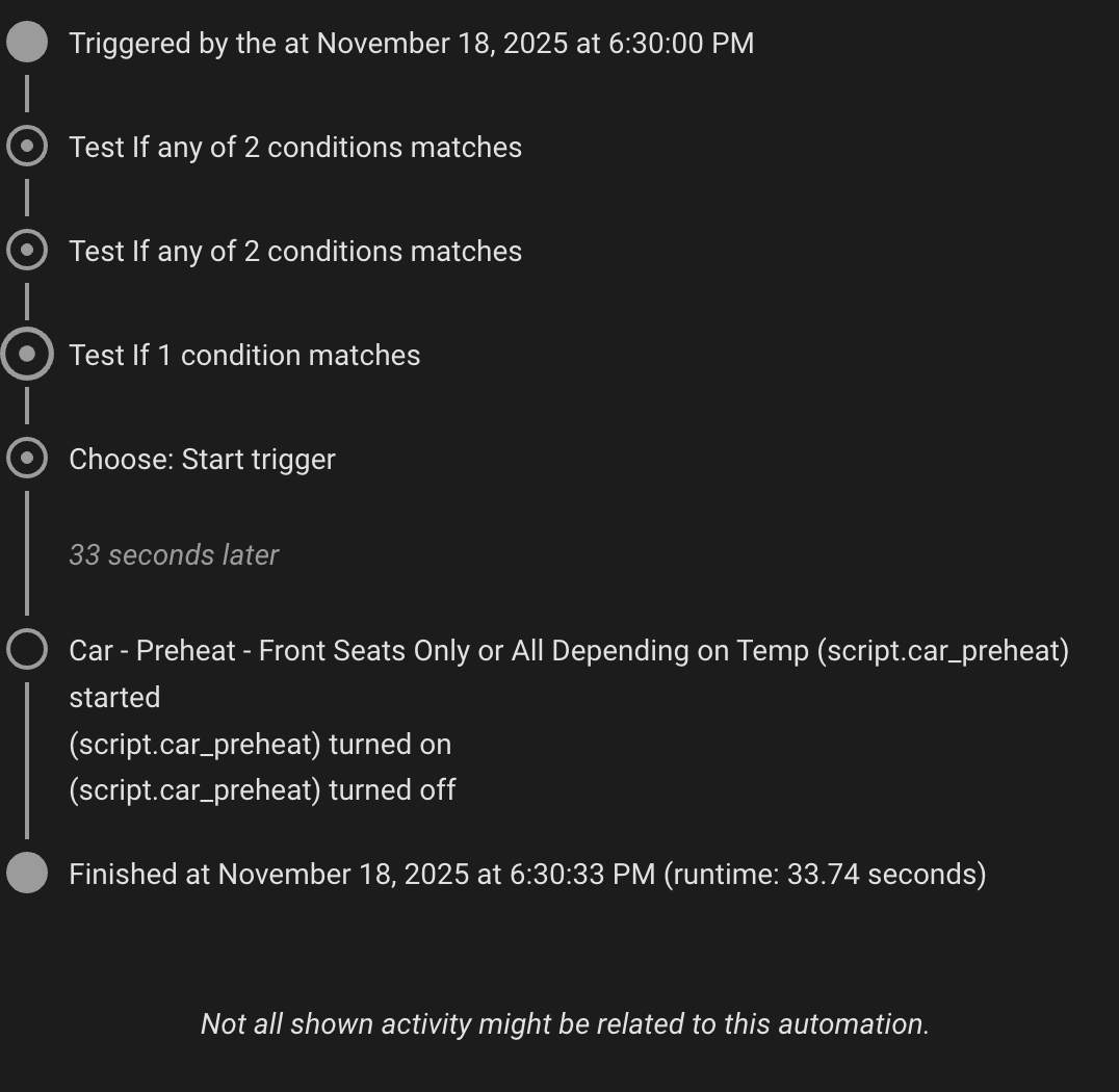

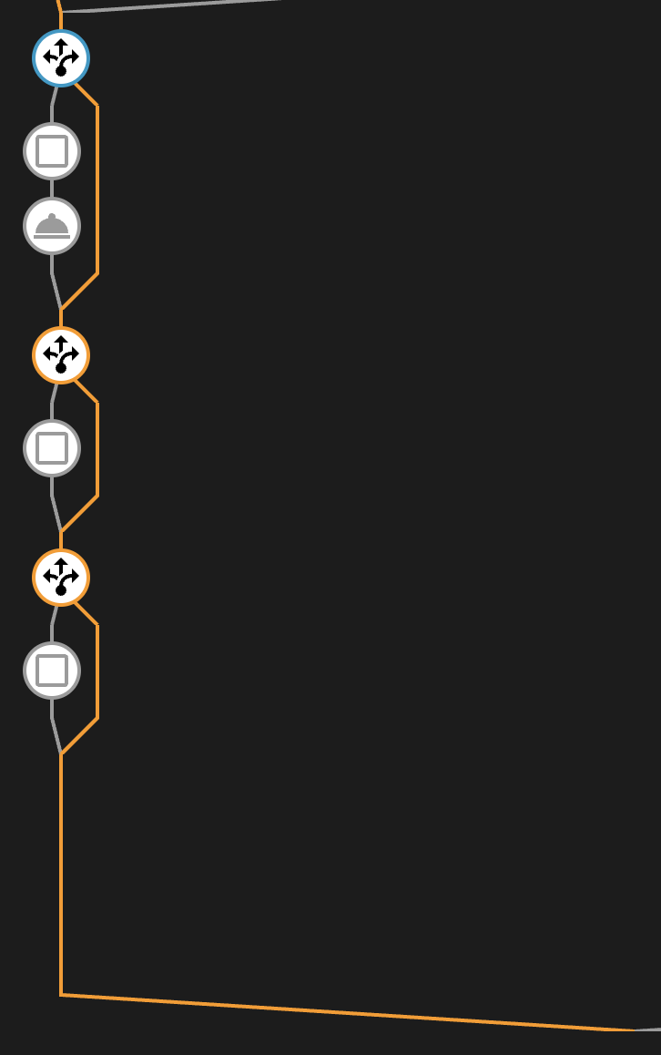

The automation triggered when expected however it errored out near the end after I confirmed the notification and it was going to run my script with:
Error in describing trigger: e.offset.startsWith is not a function
Executed: November 18, 2025 at 6:30:00 PM
Not sure from the trace if this is where it bombed:
trigger: calendar
event: start
entity_id: calendar.m365_kk
offset:
  hours: 0
  minutes: -30
  seconds: 0
  days: 0
It kinda looks like it just stops after the “check if auto action” part is reached.

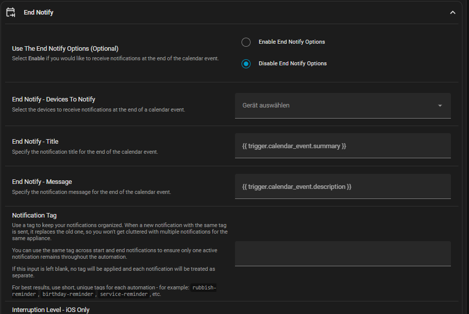

@Blacky End Notify triggers/runs when it is disabled, can you fix it?
und das Logger: homeassistant.helpers.template Quelle: helpers/template/__init__.py:2333 Erstmals aufgetreten: 08:07:21 (1 Vorkommnis) Zuletzt protokolliert: 08:07:21 Template variable error: 'dict object' has no attribute 'calendar_event' when rendering '{{ trigger.calendar_event.summary }}'
@TheFourDees
Looks like your all good now.
Enjoy
Blacky :grinning:
@stephanschleichstr13
I have tested it here again and it does not sent the end notification when it is disabled.
Blacky :grinning:
