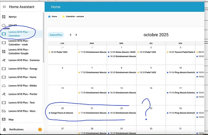

I will try to make it clear … I have installed the Google calendar on HA, I THINK this installed the “Calendar” item on the left menu of HA, I like it because this is the only one that is able to show events spread on several days like highlighted :
But displaying this page on a wall tablet running fully Kiosk, which is disabling the menus, there is no option to come back to home page once finished …
I have create another specific dashboard do display a calendar, I have put a “Home” button on that one to come back to home dashboard, but there the events are not spread on several days (only start day is mentioned) :
So my question is … is there a way to display the left menu item “Calendar” on a dashboard which is editable, meaning where I can have the “Hime” button ?

the “Home” on the dashboard indeed allows me to come back to any dashboard, like the home page …
but issue is the “Calendar” page accessible from the left men item displays a page which is not edits le, where you can’t add any button.
Reason why I was asking if possible to include this calendar page in a dashboard I build myself (with a “home” button)

Yeah but that its swiping from left to right which allows to go to Start URL … but I can’t ask the family to do that to exit the calendar and go back to home page … ;-(
It is a pity we can not just display the right frame of the calendar on a dashboard ;-(
and also a pity the standard Calendar card is not allowing to see events spread on several days ;-(
