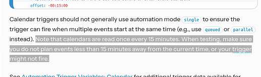

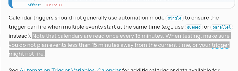

The most common reason for Calendar event triggers seemingly not working when you are starting out is failure to understand the 15 minute rule when testing…
Automations - Calendar
There are some work-arounds: Is there any life hack for using calendar for events less than 15 minutes in the future? - #2 by Didgeridrew
