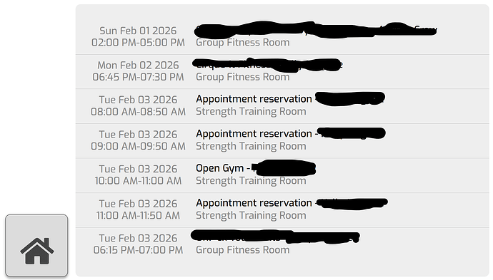

I made a little progress with this, I created a template sensor helper (using the example in the documentation for the HA Calendar feature) and now I can pull that into AppDaemon. Right now the data just shows up as an array of objects, but I think I should be able to create a custom widget to handle the formatting.
For anyone who finds this later, the two things you need are a template sensor on the HA side that creates the list of events, and custom base widget on the AppDaemon side that displays it.

Then you need to create a custom_widgets folder in your AppDaemon config folder if it’s not already there, and create both a base widget (with a descriptive name like basecalendar) as well as a derived widget called something like calendar.yaml . To create the base widget I copied the basedisplay widget files from the github repo and then modified them to suit my formatting needs.
