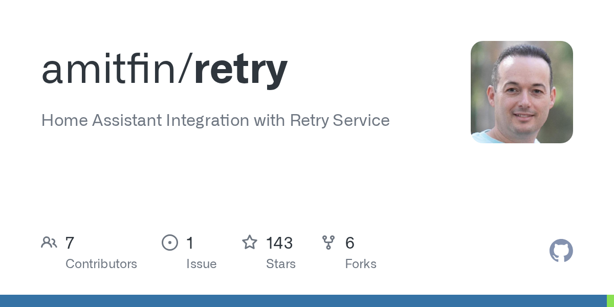

It’s what we call “fire and forget”. As mentioned, there’s no retry mechanism.
I only know about this one and haven’t used it myself.
