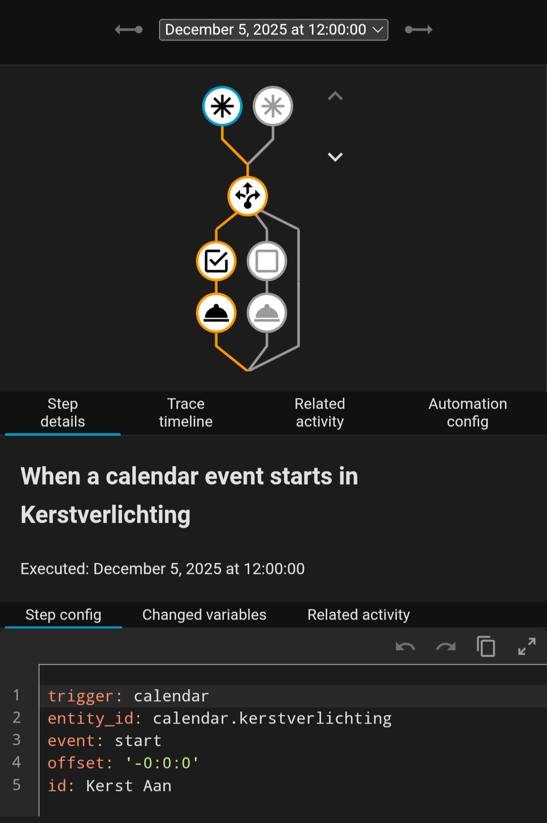

Calender event in automation, i see the trigger but no trace or action
HA is at version 2025.12.0 and i have something weird with my Xmas automation.
I made an event in a seperate google calendar for turning on the lights.
Last year it worked like a charm, but when i put in a test event today it would not trigger.
So i tested it out now and with the automation screen open i can see the blue trigger bar for both start of the event and stop.
But nothing happen and weirdly there is no trace

In HA i can see the calendar and the event i made. And like i said, i do see the trigger blue bar but no trace for some reason.
Edit:
The entity state shows it sees the calendar (without the test the next should be the 11th)
message: Kerst Aan
all_day: false
start_time: "2025-12-11 16:00:00"
end_time: "2025-12-12 00:00:00"
location: ""
description: ""
offset_reached: false
friendly_name: Kerstverlichting
supported_features: 3
Did you observe the 15 minute rule, or use the workarounds?
No, i did not :man_facepalming:
Put in a test for today at 12:00, its 10:27 now so it should trigger.
If it does i will feel pretty stupid. Was fooled by the trigger showing in the automation editor.
So, yeah it works :sweat_smile:
Yeah, I’m not sure how that works exactly, but I’ve seen it too.
