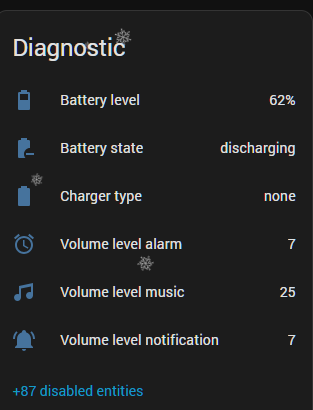

To add, the max volume levels have different maxs. My notification and alarm, the max is 7. Music is 25. If you send a number over the max, it will do nothing.
You can enable, in the diagnostic section of the device, sensors that will show you the value. These only show the current value and cannot be used to to change the level.

I’ve used the code from @Biscuit and the suggestions from @Mikefila and now it’s working!
