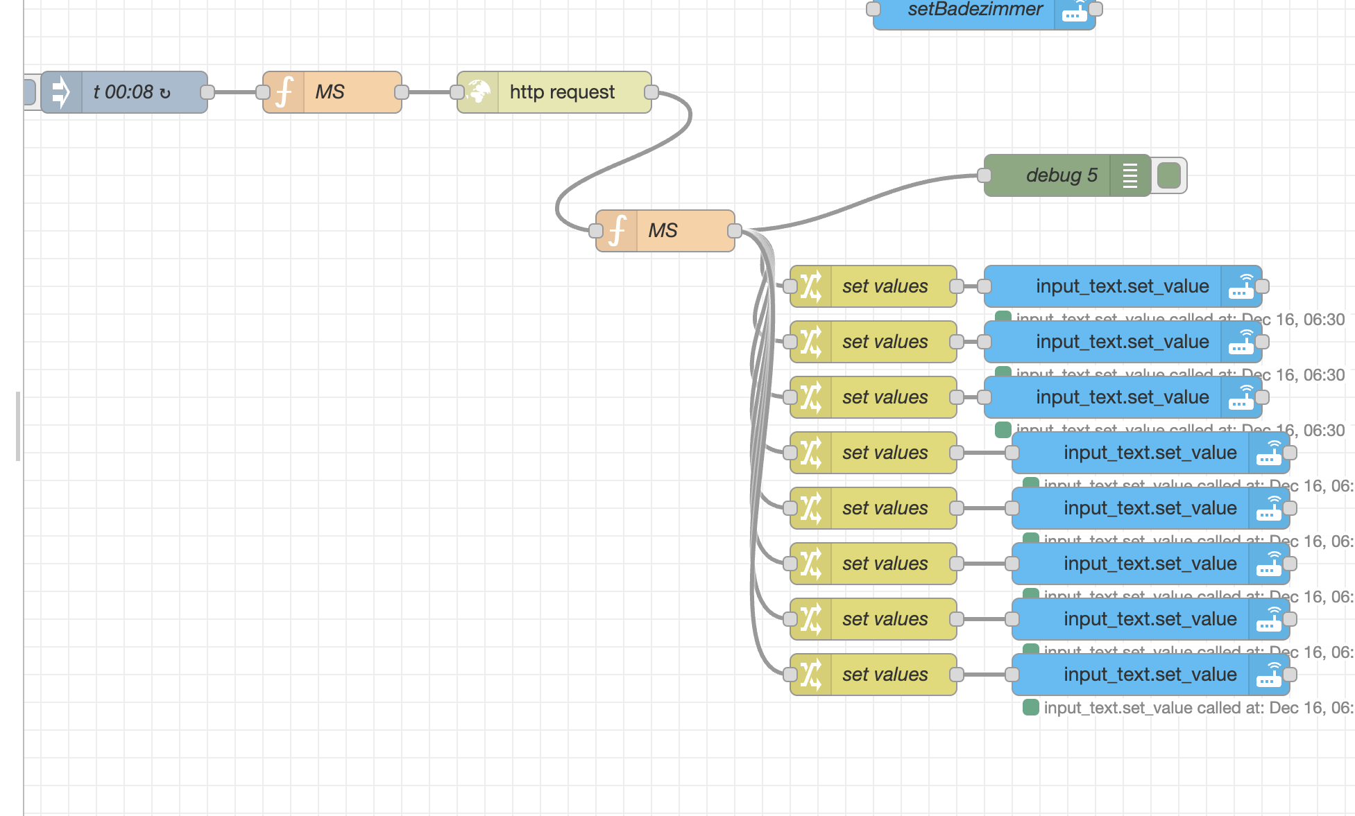

So basically I have an external display driven by openhasp and I want to display a result from an API on it. The result are a few sentences to be put on the display. As this display does not have text boxes (at least I am unaware of it) I have to split the result in “lines” and put them individually on the display. I solved this by having 8 entities with text_input which will then be filled. This is more than needed, usually only 3-4 items are used, dependend on the result every day delivers.
Anyhow,
I use node red, call the service and receive the result as a json, this is then passed back and split in a function into the individual lines.
I am unable to return a array and map the single values to the entities, so I mapped the values to global objects (global.set(“myLine1”, line1) etc.
Then in the next node, I use 8 mappings, read what is in the global object “myLine1” and pass it as payload to an action node. This happens 8 times in parallel. It works but it is not nice - is there a smarter solution?
Potentially outside of NodeRed? If possible want to stick to it as I like to stick to one environment.
Below my flow for reference.
Thanks in advance!
S.

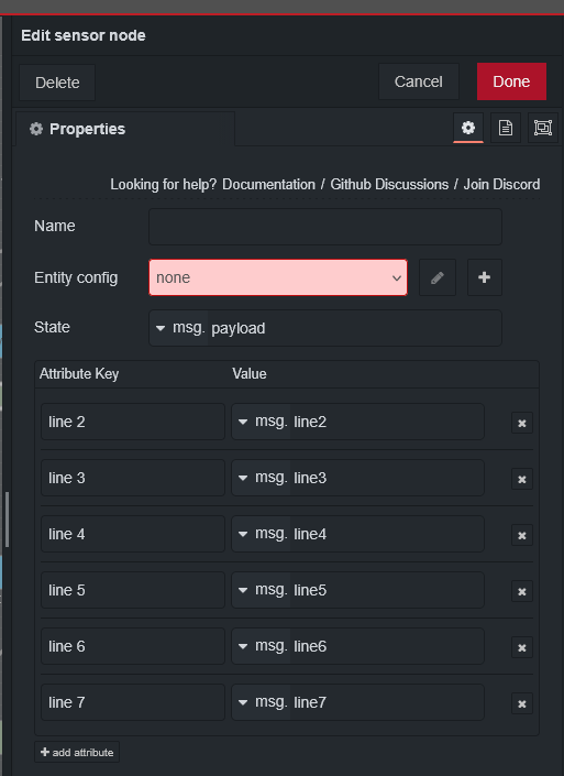

You also have the ability to create entities in NR. Using a sensor entity node in lieu of a text entity, you can store each line in an attribute of a sensor.
Hi, I will look into this. However this is not in Node-Red
