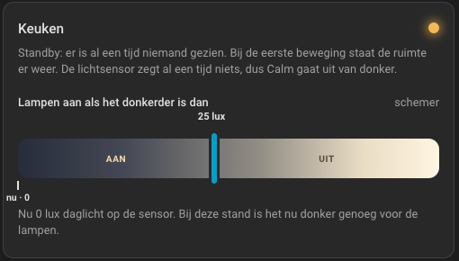

    Motion, standby, nightlight, overrides (work light, film, …) and conditions such as somebody home and night mode off. When something else touches the lamps, Calm steps aside.
Rooms come straight from your Home Assistant areas and follow them. Everything is set up in the UI, and there is an optional dashboard card to set the line against the live daylight.
