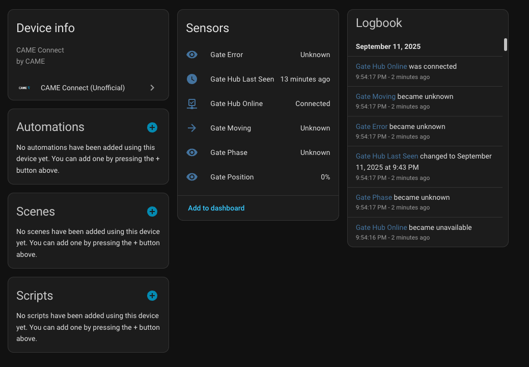

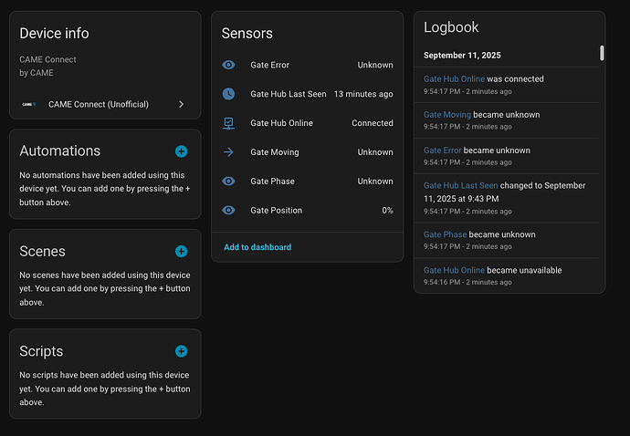

thank you for your fantastic work. Just got my came gate/automation installed with Came Key Wifi Gateway. What a surprise it was to see that the custom integration was just developed 6 days ago! what are the chances :slight_smile:
I followed the installation instructions in github, and managed to configure the integration. I can see my Gate available in the integration UI, but…
I see only Sensors - i cant execute any actions. On top of that, it looks like only “Gate Hub Online” entity is showing correct value - connected. Everything else is just “unknown” or 0% for gate position (and it is not changing). The only other entity that is reacting, kind of, properly is “Gate Hub Last Seen” which, at least looks like, is showing the last time i interacted with the gate.
Any ideas what it be wrong? Is it “me” or there is a bug in the integration?

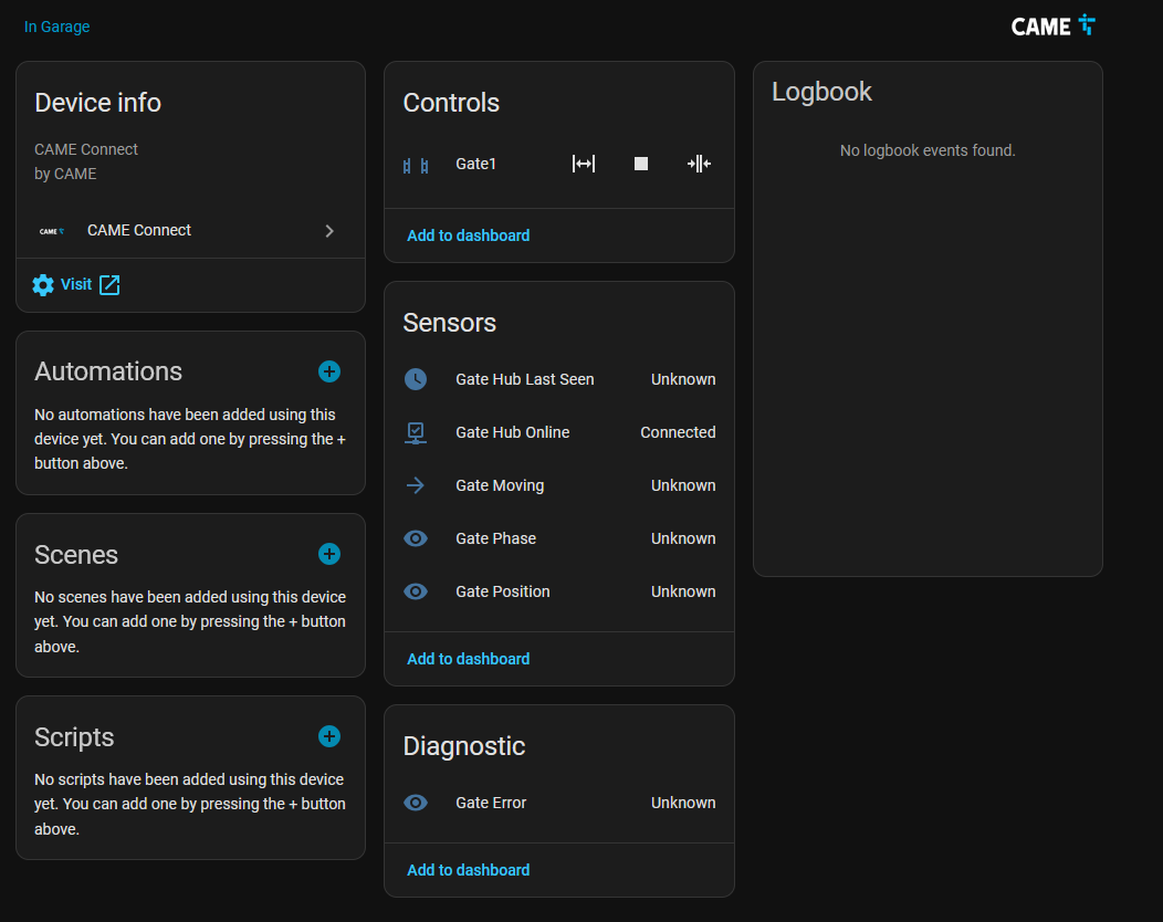

thank you very much for the quick response!
Of course i understand that this is not a professional-grade extension and that, most probably, you a re implementing it in your free time which, as most of us, you don’t have that much. So i dont expect everything to work out of the box, and i am happy to help at least with testing to fix al/some of those issues.
To clarify, my hardware is:
  • Came Key Wifi Gate (FW: 1.1.26)
  • Gate Automation: ZN7 (FW: 2.6.4)

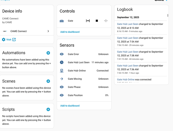

After downloading version 1.1.0 of the integration i see the progress in a good direction, but still not everything is working.
  1. I do see the actions right now
  2. most of the sensors are still in “unknown” status, except for:
    2.1 Gate Hub Last Seen
    2.2 Gate Hub Online
When i press on the “open” button the gate actuaklly starts to open but the close button is always disabled (as visible on the screen). I guess it is due to the fact that the integration doesnt know if the status of the gate, and the Default gate position is always “0%” so it assumes that it is always fully closed.
I had a look at the cameconnect UI to look at what endpoints are reporting on the gate status in my case and it looks like it is this one:
https://app.cameconnect.net/api/devicestatus?devices=[DEVICE_ID]
Looks like the Data->States->Data property reports on what is happening with the gate. Looks like the first item in that array is the code for the movement and the second one is the position of the gate
  • 17 - closed
  • 32 - openning
  • 19 - partially open
  • 16 - fully opened
  • 33 - closing
I guess you know what already, but maybe it is different for my hardware than yours - that would explain why the sensors are not working.

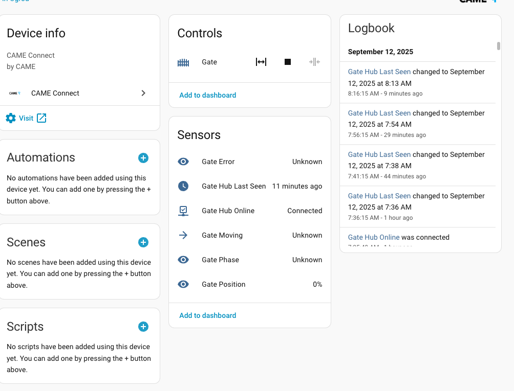

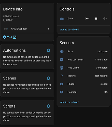

Hey Michal — huge thanks for the detailed write-up and for testing :+1:
Quick update: I’ve just pushed v1.2.0, which is a big rewrite. The integration now runs WebSocket-first (like the CAME web app) so state changes are pushed to HA in real time. That means:
  • No periodic polling anymore (except a single /devicestatus fetch at startup to seed state).
  • Live updates for Open/Opening/Closing/Closed/Stopped (we now map phase 19 as Stopped).
  • Entities (phase/position/moving) are populated immediately by the initial seed, and then kept in sync by WebSocket events.
  • The Close button shouldn’t be stuck disabled—HA knows the phase/position from the seed + WS events.
Your observations about States[2].Data = [phase, percent] are spot-on and exactly what v1.2.0 uses under the hood.
What to do
  1. Update to v1.2.0 in HACS (or pull latest).
  2. If you were on an older build, I recommend: Remove the integration → Restart HA → Add it again (clears old options).
  3. In Options, you’ll now only see:
  • Redirect URI (default https://app.cameconnect.net/role)
  • WebSocket URL (default wss://app.cameconnect.net/api/events-real-time)
  1. Open/close the gate once (from HA or the CAME app) and confirm the HA entities move through Opening → Open → Closing → Closed.
If something still looks off
Please enable debug logging and share the snippets around an open/close cycle:
logger:
  default: warning
  logs:
    custom_components.came_connect: debug
    custom_components.came_connect.api.ws: debug
You should see lines like:
WS connected
WS TEXT: {... VarcoStatusUpdate ... "Payload":[32, 58]}  # Opening 58%
If you don’t get those VarcoStatusUpdate frames:
  • double-check Redirect URI matches the site you log into (usually https://app.cameconnect.net/role);
  • and that WebSocket URL is the default above.
Hardware notes
I’ve been testing on a ZLX24SA; your ZN7 reports the same phase codes (16/17/32/33/19), which we now handle uniformly. If your device ever emits a variant, the logs will show it and I’ll add support.
Really appreciate you helping test this—v1.2.0 should be snappier and more reliable. Let me know how it behaves on your ZN7!

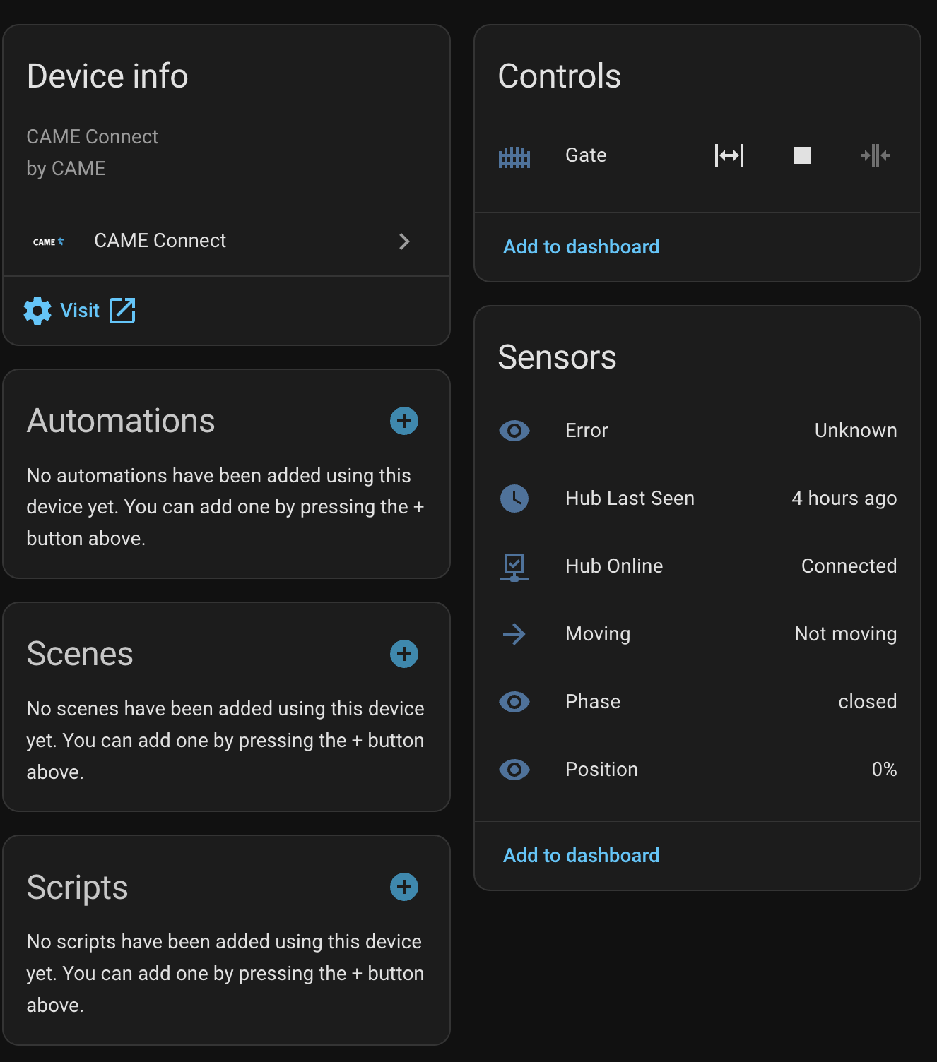

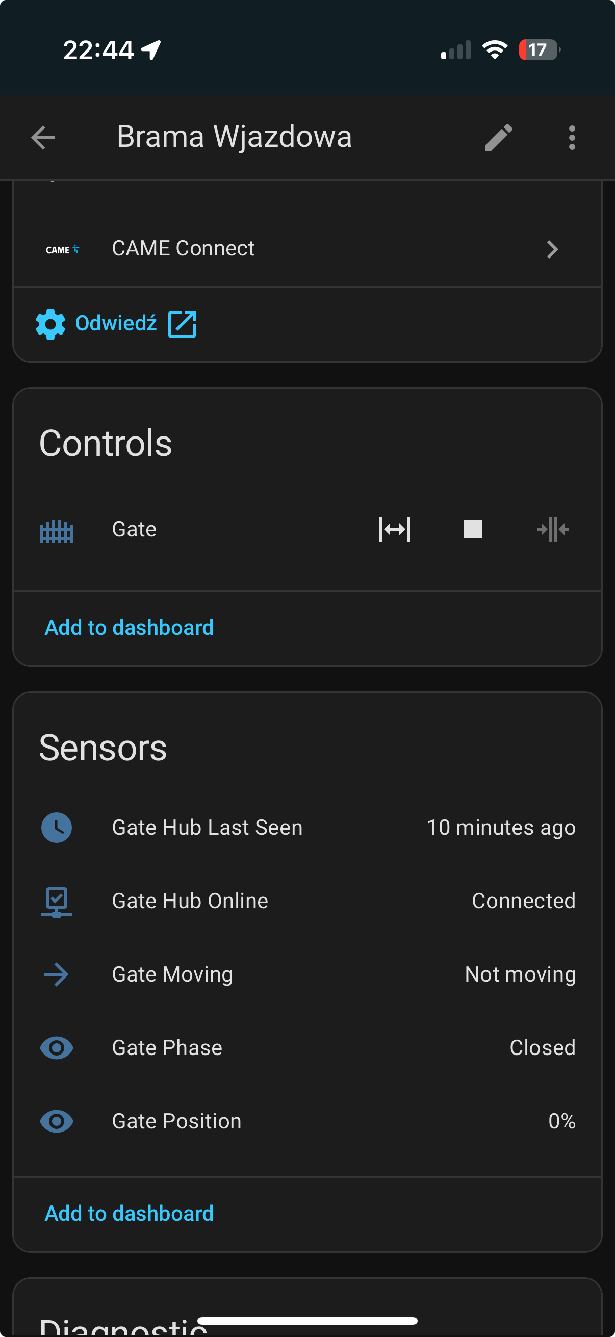

Hello!
I seriously can’t stress enough how grateful I am for your work!
Just upgraded to 1.2.0 (without removing the integration) and looks like all is working now. I do see the proper status of all entities and I was able to open and close the gate!
It is 10:41 PM right now in Poland so I will do more testing tomorrow during the day. But this release looks very promising!! Moving to web sockets is also a great addition, push will be so much better in this case than a pull! I really appreciated your concern about pulling cameconnect too often from the start (they might block us due to that)!!

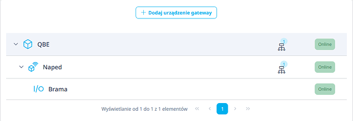

Hi!
I managed to get it up and running without any errors, but my Gate doesn’t seem to react to any HA buttons. I assume it’s because my Garage Door controller is a simple Input/Output board soldered into my Garage Door Controller?
I’ve tried adding both “Naped” Device ID and “Brama” Device ID - no reaction.
If you had some time and/or need any more information - let me know if I can provide anything!
I managed to brutally “fix” this for myself and changed the api from /automations/ to /multiio/ in “send_command” function and it works for now.

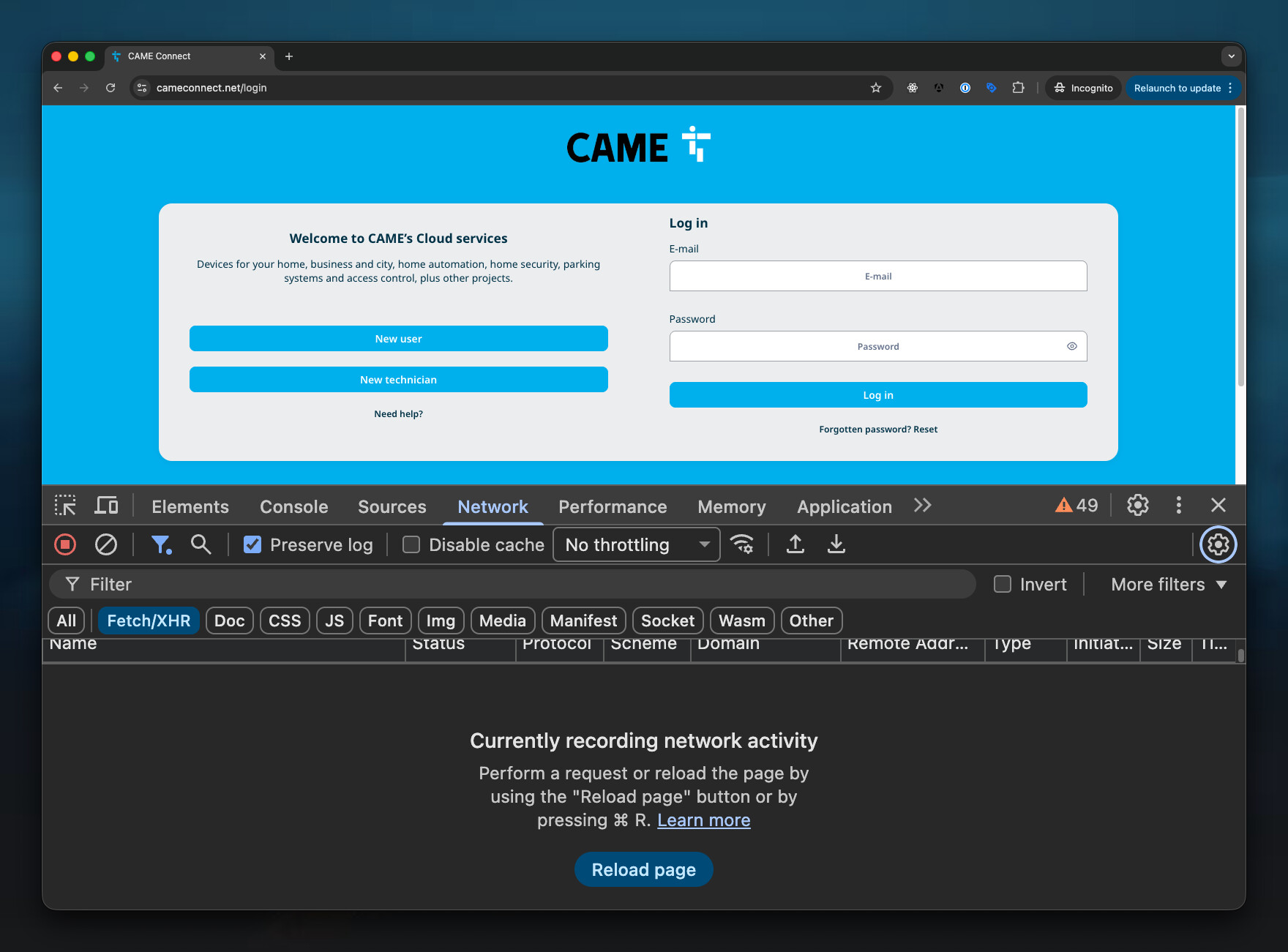

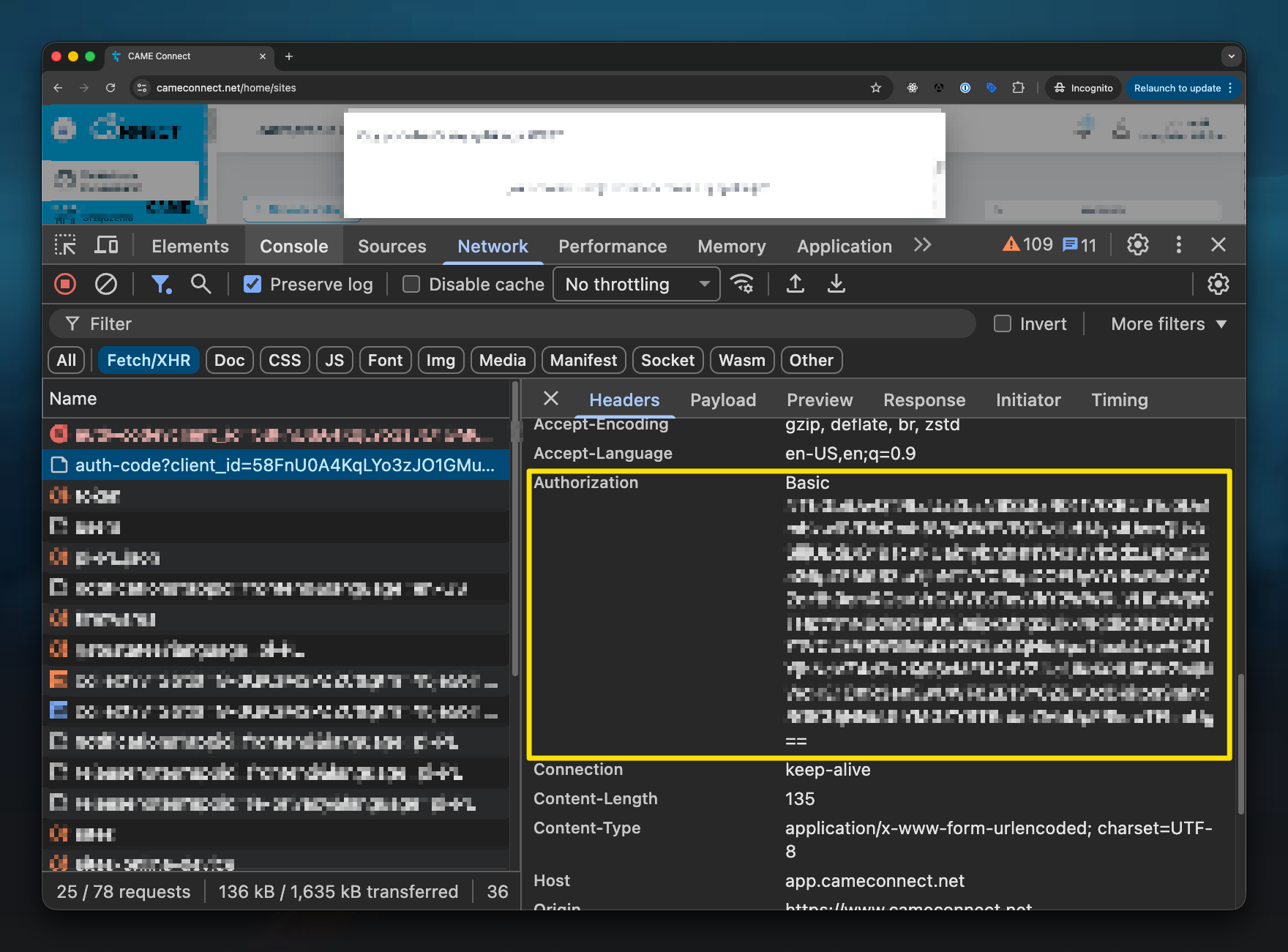

Thanks, but under the autorization “Basic” I have 388 characther… and no one :… :sob:

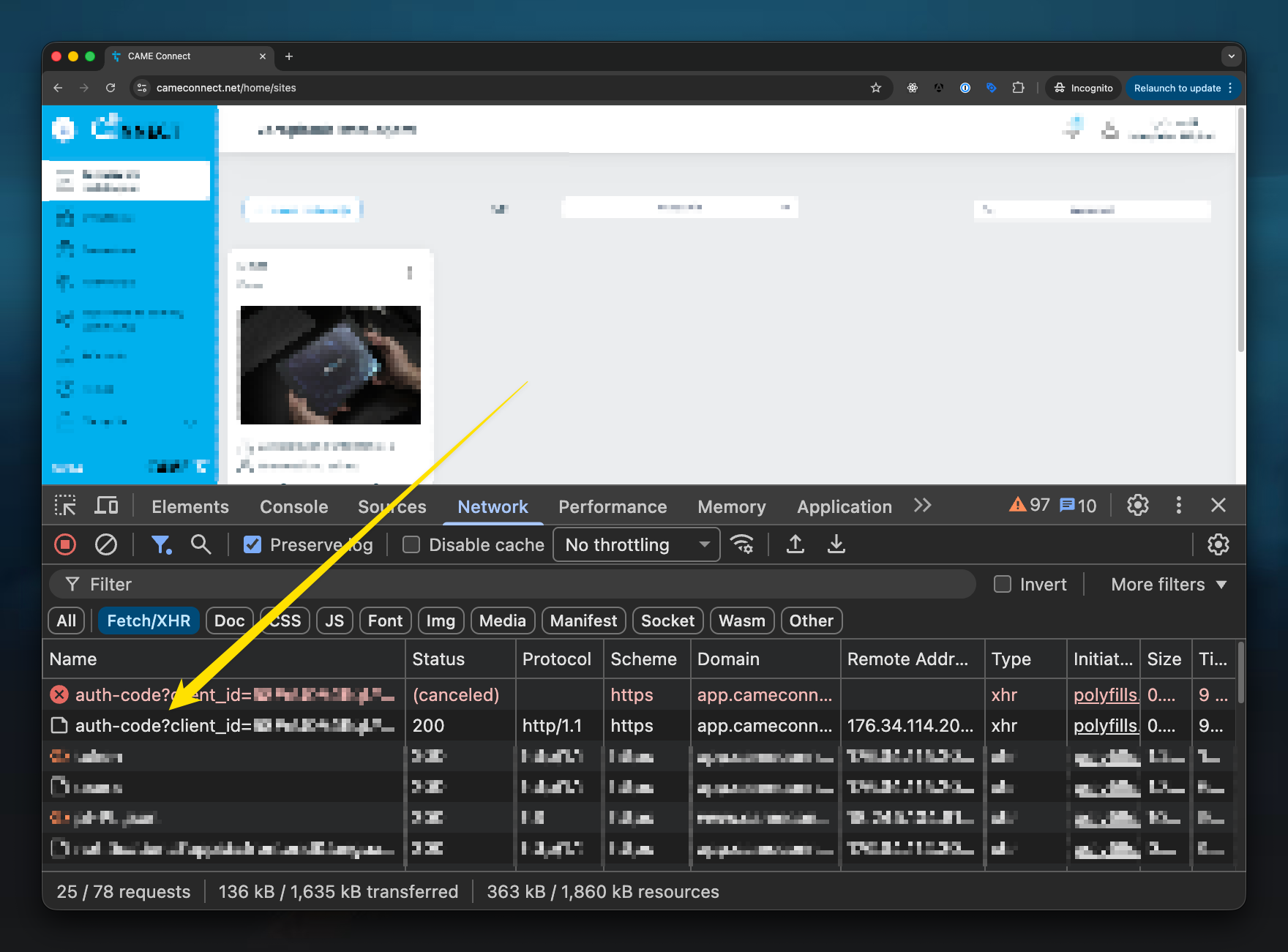

try following those steps:
  1. go to: https://www.cameconnect.net/
  2. open web developer tools, and go to network tab
  3. login with you credentials
  4. in the network tab, search for auth-code call. The URL will include the client_id - one of the values you need.
  5. click on that call, and in “Headers” tab scroll down to “Authorization” header
  6. copy the value of the header WITHOUT “Basic” part. Most probably this will end with == - but not necesairly.
  7. that value is base64 encoded value of your client_id AND a secret. So you need co decode it. for that you can use, for example, this website:
    Base64 Decode - Online Tools
  8. put the value in the “input” are, and the output will show values something like:
    jksdnfkasldkfas:kasjwenbdfajsndaskndmakmsdkadmaksdasdasdd
i.e. 2 values seperated by :. The first value is your client_id (you can confirm that by comparing against the value from step 4), and the second one is the secret you are looking for.
Hope it helped. if not - let me know.
Yep!! Resolt, thanks a lot, I understood where I made a mistake!!!
