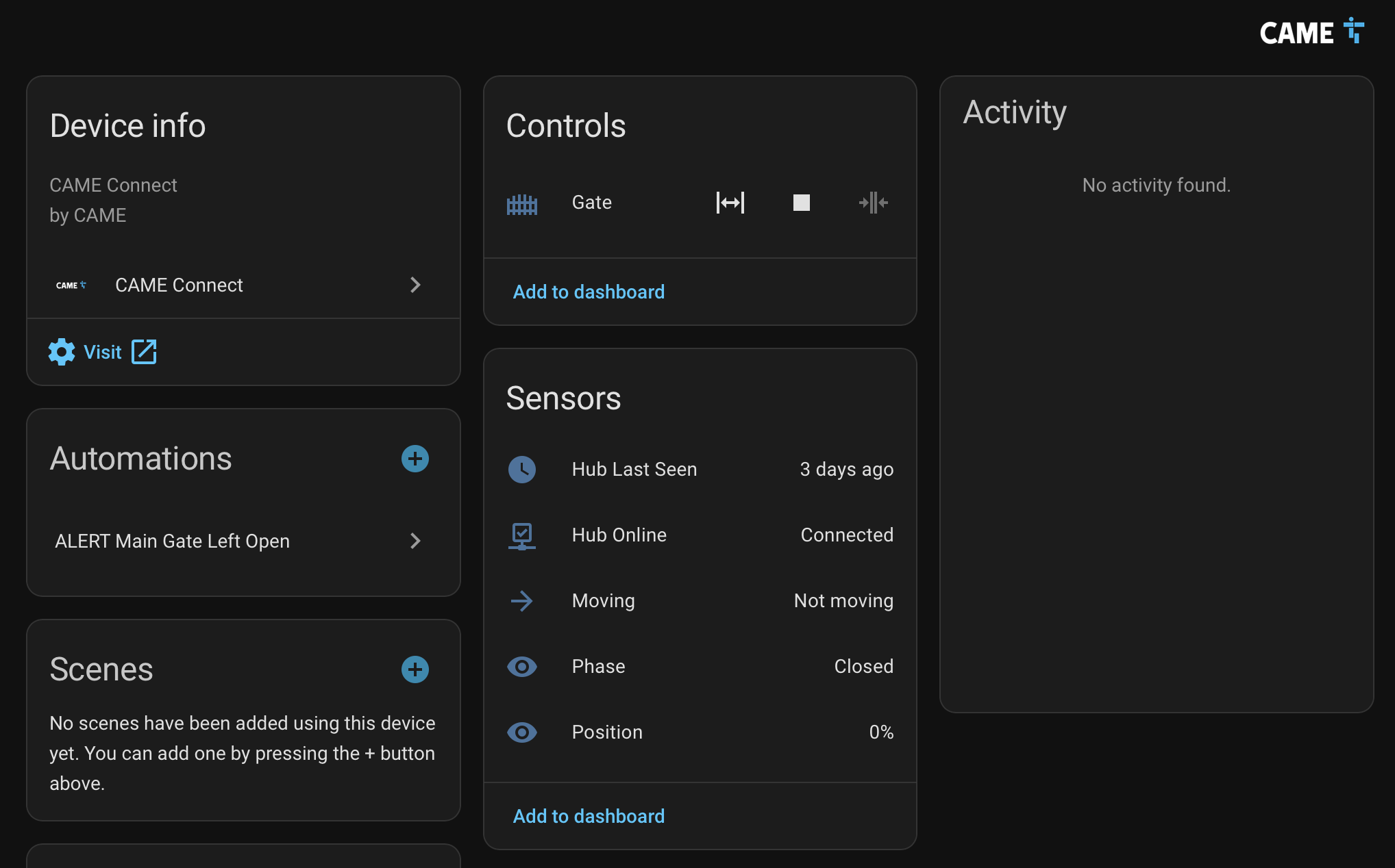

I’ve been using this Integration for a few months without issue. Just recently, all the sensors have quit reporting. I can still use the Open & Stop Buttons (The Close Button was always greyed out which didn’t bother me) but the sensors were useful because I wrote an automation to check on the position and now its obviously doesn’t work.
Any Idea’s why the sensor data has stopped updating?
P.S.
The screenshot below shows the out of date sensor data from last HA reboot.
The gate is actually “Open” and in a “Stopped” state at the time of taking that screenshot as waiting on a Pizza delivery LOL.
I ran into exactly the same thing and it turned out not to be a Home Assistant bug, but a limitation of the CAME Connect cloud API.
CAME Connect only publishes real status updates (VarcoStatusUpdate) while the gate is physically moving. When the gate is idle for a while, the WebSocket goes quiet and the REST /devicestatus endpoint often returns cached or incomplete data. When the integration relied on that, sensors like phase, moving and position would either freeze or drop to unknown, even though commands like Open, Close and Stop still worked.
What I changed locally was to store (latch) the last known good state that arrived via a real push update. Phase and position are only updated when a valid motion event comes in. When the gate is idle and no new events arrive, the integration keeps the last known values instead of overwriting them with unknown. That immediately stopped the sensors “dying” after idle periods.
There is one important caveat though. After a Home Assistant restart, the integration starts cold. If the CAME cloud does not provide a valid current phase and position in the initial REST snapshot, there is nothing trustworthy to latch yet. In that case the sensors can still show unknown or 0% until the gate is moved once. Triggering a single open or close forces the cloud to emit fresh motion updates, after which the state is correct again and remains stable while idle.
So in short:
• Commands still work because they are command endpoints, not state driven
• Sensor data goes stale because CAME does not push idle state
• Latching the last known state fixes it during normal operation
• A restart still needs one real movement unless state is persisted across reboots
If CAME ever add a proper “status refresh” or heartbeat endpoint, the integration could be improved further, but with the current API this is about as reliable as it gets
