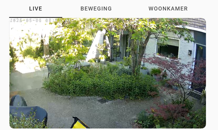

Now, just create a dashboard card. I created a tabbed card, because that more beautiful. I have 3 tabs. One with the live feed, one with the movement picture card (carousel) and one is the live feed of my wall mounted tablet.

I first had the script being executed every 5 seconds, This way you have an automated carousel, but I wanted to change it to manual, so added the button.
