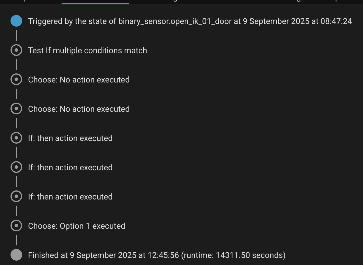

So… Is there any fix to this?
I had to manually stop it, and still look at the runtime:
