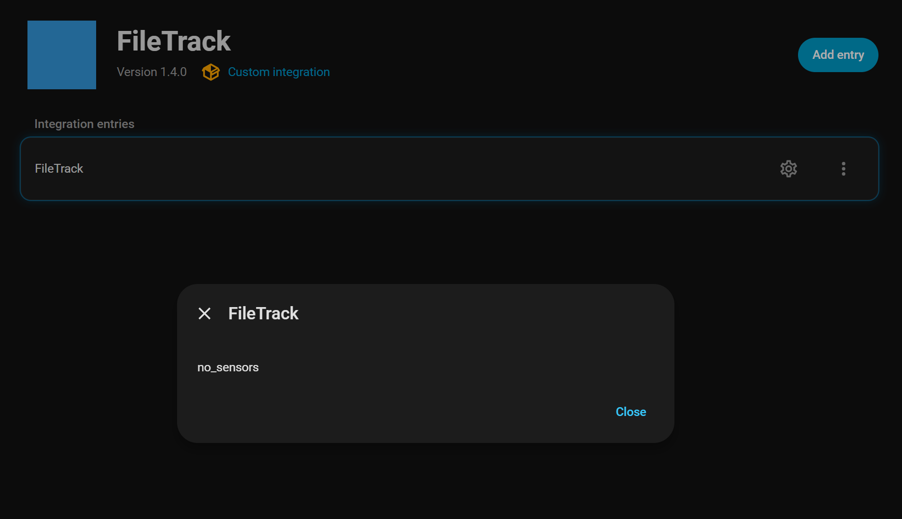

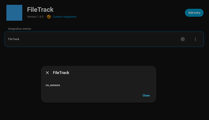

But I have following issue (running your 2.2.0 and HA 2026.4.0), after adding integration for FileTrack, I do not get any dialog, and I can’t use mode: sensor
PS; I’m old-school so use straight YAML and not any UI setup tools …

This is what I get and see ref FileTrack:

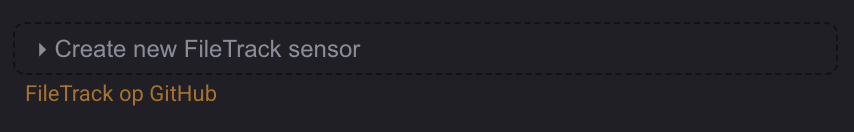

Edit: You only way to make a sensor is using the UI. Are you still not able to see the Create new file sensor part?

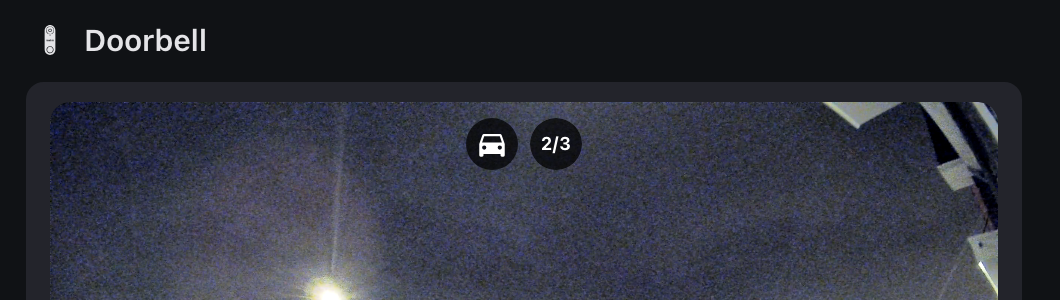

It’s just a simple header/title card :smiley:
type: heading
icon: phu:reolink-doorbell
heading: Doorbell
heading_style: title

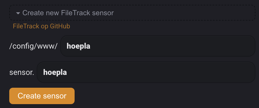

In that case you’ll need a file sensor to show the files. Did you by any chance read the ReadMe file on GitHub? FileTrack (for sensor mode)
All you have to do is install FileTrack and you can add the sensor and folder in the editor as you can see in the example below. ā€˜hoepla’ is just an example.
You could replace bothe ā€˜hoepla’ with ā€˜camera_snapshots’.
Folder would be /config/www/camera_snapshots
Sensor would be sensor.camera_snapshots
After you press ā€˜Create sensor’ you fill in the sensor at File Sensor at you’re all set!
