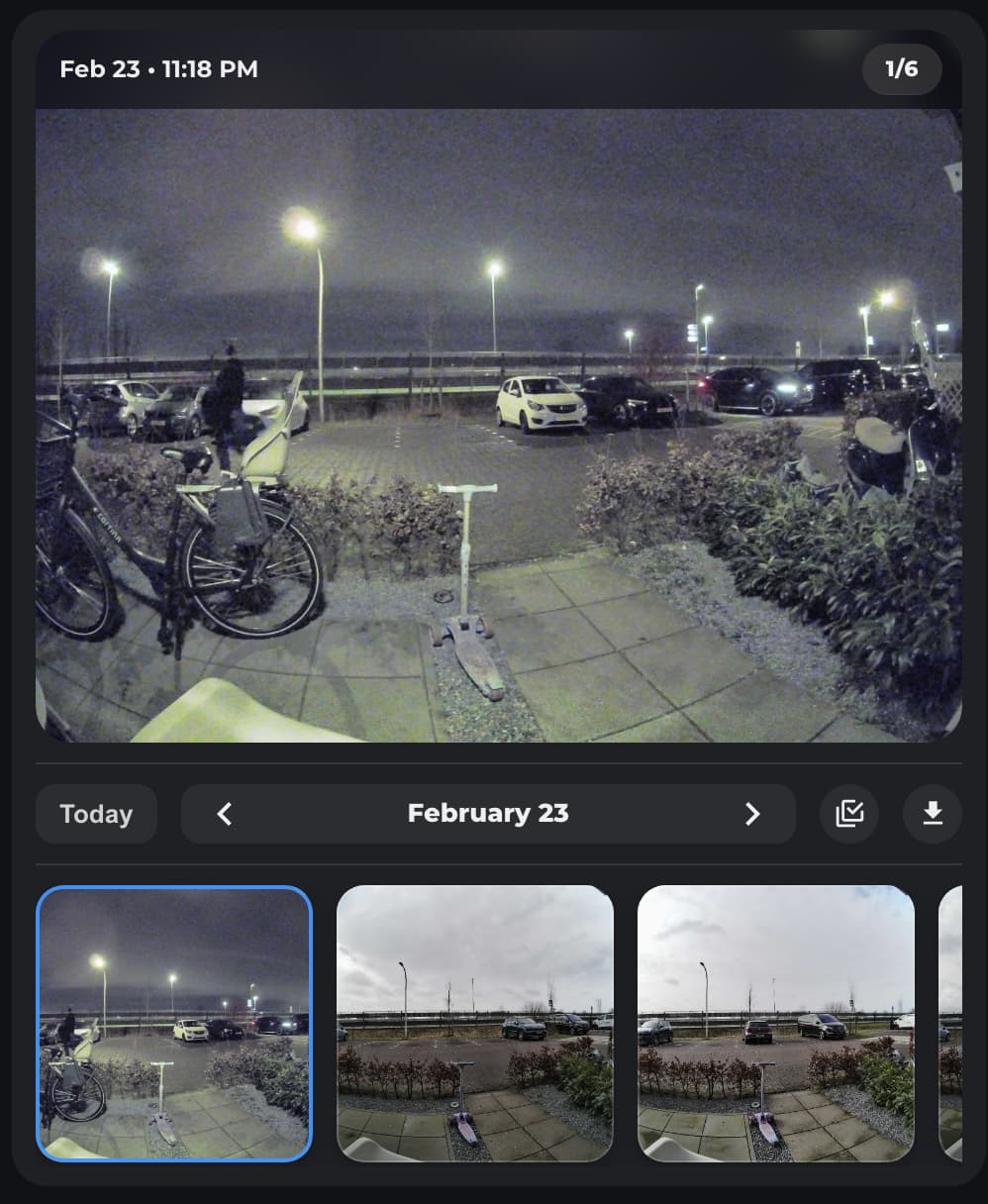

Hey everyone,
I’ve been building a Camera Gallery Card for Home Assistant and I’m looking for people who’d be willing to test it and give me honest feedback.
The main reason I started this project is simple: I felt like Home Assistant was missing a proper gallery browser for local camera recordings for my needs.
So I started creating my own version and is here to test!
GitHub: Camera Gallery Card
Right now it includes:
  • Swipeable preview for images and videos
  • Day filtering with a quick “Today” view
  • Timeline with thumbnails. Sorted on date
  • Download button
  • Bulk select and delete functionality
  • Configurable preview height
  • Configurable thumbnail size
At the moment it only supports local storage (for example files in /config/www), so no external or cloud-based media yet.
It’s working well in my own setup, but real-world testing always reveals things you don’t notice yourself.
If you’re a setup that stores recordings locally and exposes a fileList attribute, I’d really appreciate you trying it out. I’m mainly looking for feedback on usability, mobile behavior, performance, and feature ideas.
Been working on this for 2 weeks now and this is my first creation. Hope you like it!

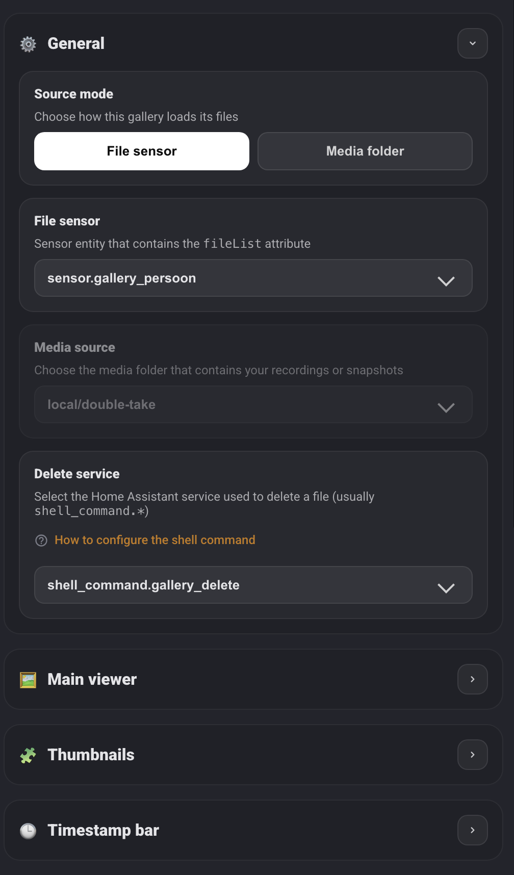

Update – v1.0.1 released :tada:
Added:
  • Source mode (File sensor or Media folder)
  • Configurable preview position
  • Optional preview-on-click behavior
  • Completely redesigned editor with automatic dropdowns
    • File sensors
    • Media folders
    • shell_command services
Also includes internal cleanup and stability improvements.
Feedback still very welcome :raised_hands:

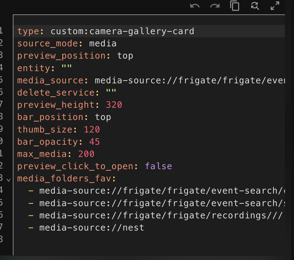

Do I need to use YAML to add my frigate clips folder?

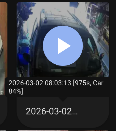

As for your question, well Frigate actually seems to put what the clip is in the file name itself (see below), maybe you could look at that… this would be the easy way without having to use the HA Frigate integrations API
Sending the update for Frigate within 30 minutes, so it should all be visible through the dropdown.
So it puts every clip in one folder and puts the name of the tracked event in the name. A person/dog/cat/car filter would work then.

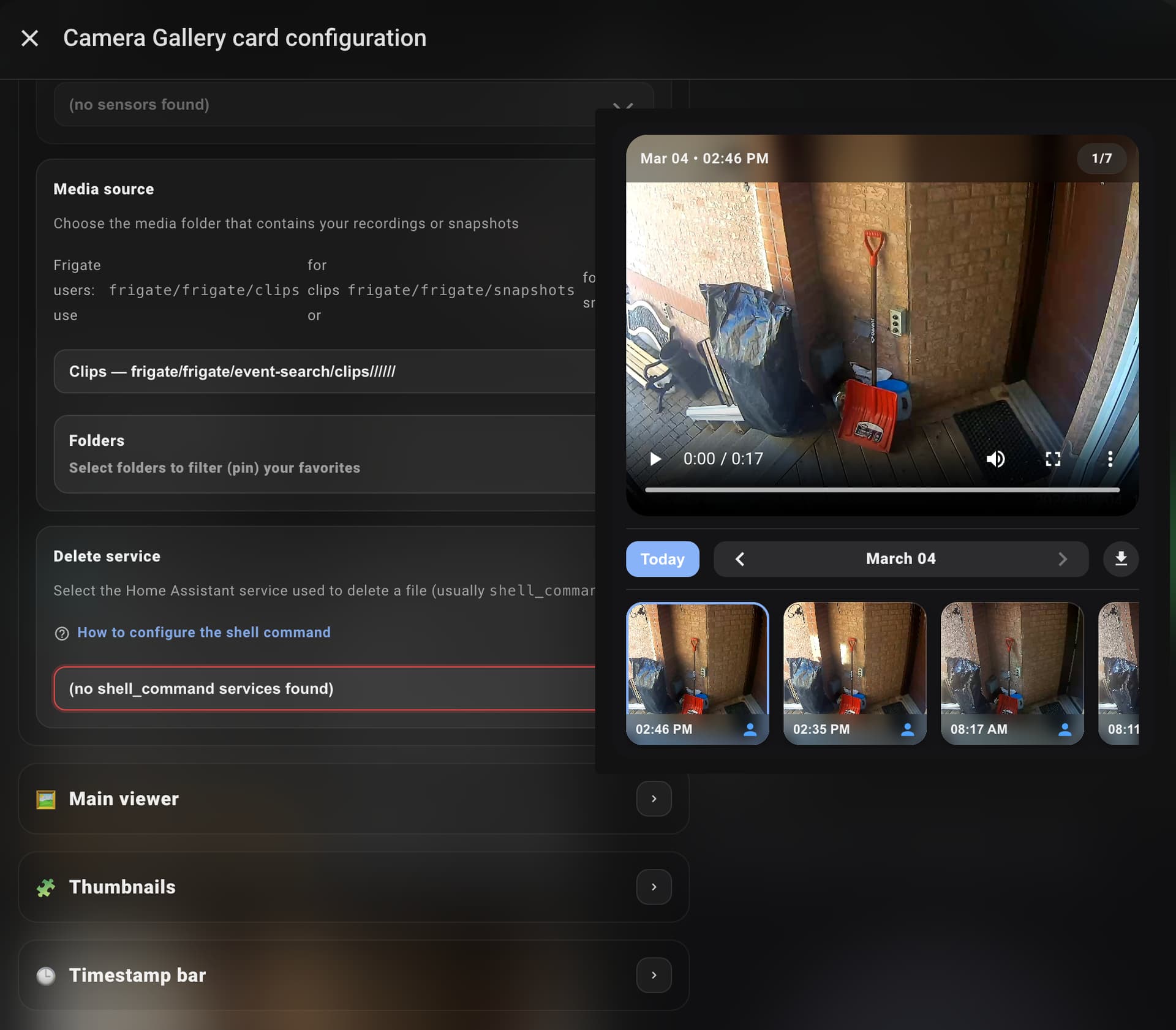

I can’t get the clips or recording folders to show anything so I guess no videos supported.
Snapshots folder seems to work after a very long loading time… which is annoying but whats weird is when it does finally load it seems to show the same duplicate snapshot like 8-10 times, weird bug. Is there anyway to make sure it always shows the latest snapshot first and also no duplicates?
Another thing weird with snapshot folder it seems to randomly change itself like it’ll show snapshots from day but flip between a clip from day or night randomly.
Almost got it working. Will update soon.
UPDATED!
Ok finally got updated and gonna test it out a bit, just a heads up the editor seems a bit broken now… I had to hard clear my cache to get it working Chrome so annoying sometimes…
Also just wondering is it possible to have multiple media sources? I added multiple favorites but seems thats only for the media source selector, still card is only the one media-soruce.
