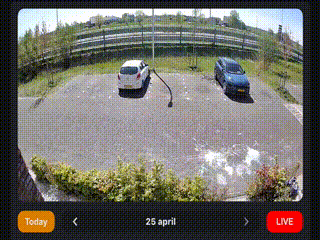

  • Pinch to zoom :white_check_mark:
  • Added chevron’s for switching between camera’s :white_check_mark:
Schermopname 2026-04-25 om 13.35.59 (4)
As for the push to talk; how are you planning to use that? Tablet, phone? Working on that, but it’s a pain.

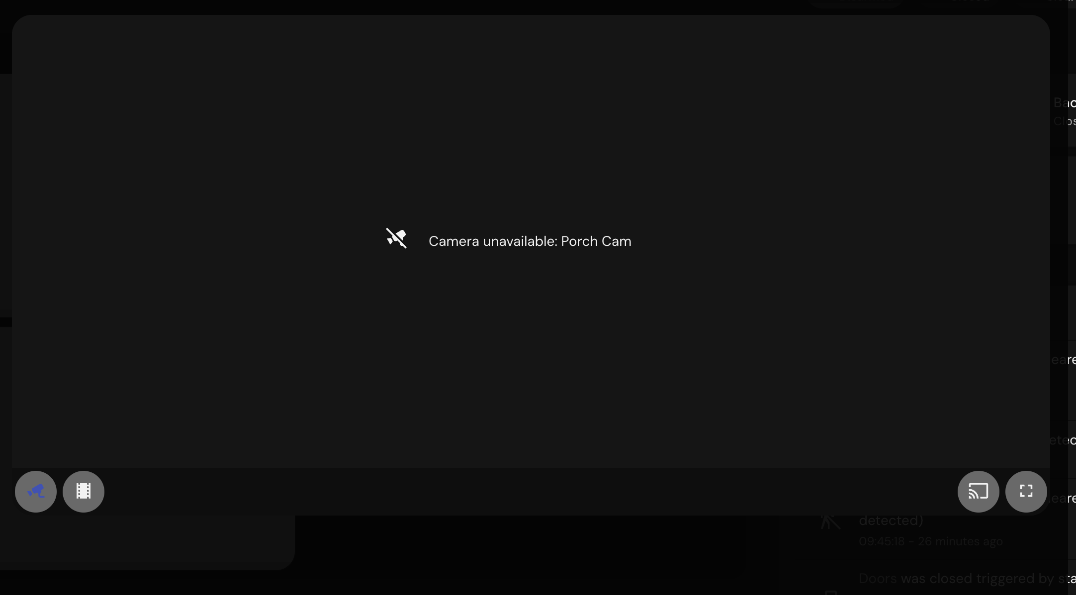

I wanted to ask if you could improve this screen? Basically, when the camera is offline/unavailable it should display something like the AC card. Thanks
Camera Gallery Card:
AC Card:
Thanks for the feedback, iona!
The best place for this is the GitHub Issues pag. That way we can properly track it and others can follow along too.
Camera Gallery Card - Issues
Feel free to open an issue there and we’ll take a look!
