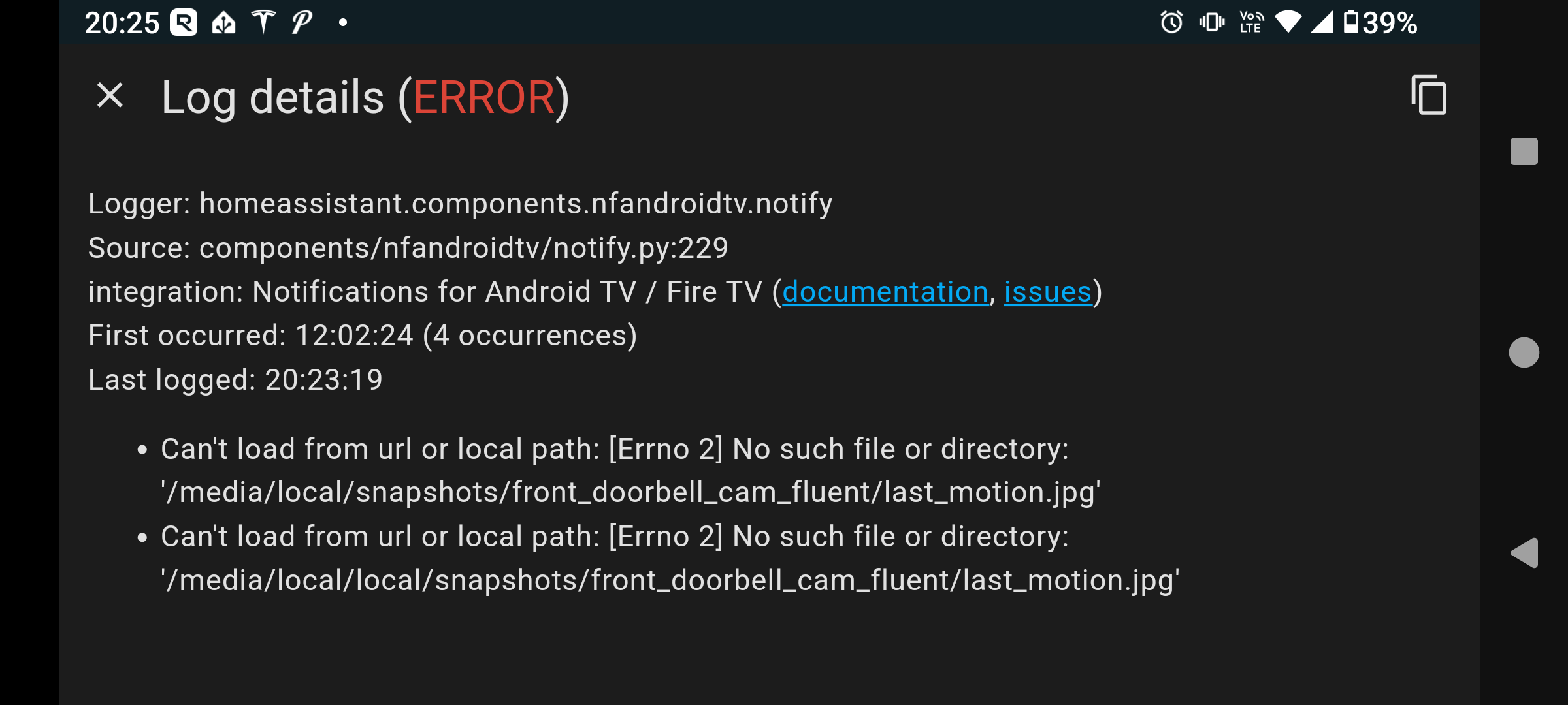

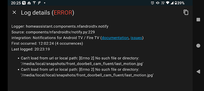

i have discovered the reason that the snapshot didn’t show. It is because the blueprint changes /media/ to /media/local/ so the snapshot saved to the media folder but when displaying the notification tries to load from media/local and fails.
Why is this done? I have removed this path change from the blue print and now it displays the snapshot as expected
either works, one is an array, one is single-line. I just prefer to write using arrays when possible.
Look at the location you may be saving. My default locations work out of the box. But HA needs to have /local after media, so my blueprint does that automatically. If your url includes /local, remove it, as it being added, so the folder doesn’t actually exist where it’s trying to load from. I believe I have this mentioned in the section in the blueprint itself. Lemme know if it isn’t clear.
