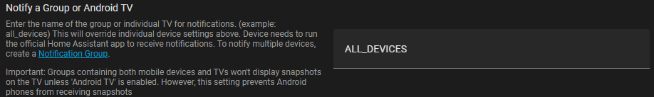

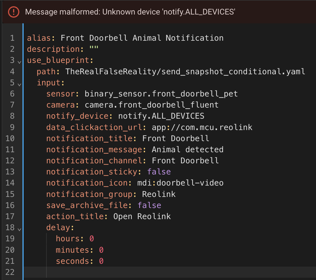

Reply to an old post, but are notification groups working in v2.3? I’m getting the same error as the post you replied to here. But I’m also not sure if I set up the notification group correctly.
In my configuration.yaml, I’ve added
notify:
  - name: ALL_DEVICES
    platform: group
    services:
      - action: mobile_app_pixel_8
      - action: mobile_app_pixel_7_pro
but I’m not sure if I have the name of the mobile devices right, or if I need to restart something to ingest these configuration.yaml changes.
And then I added notify.ALL_DEVICES to the notify_device in my blueprint, but get the malformed error seen here:
EDIT: After restarting HA I’m still seeing the same error as above.
Put it in notify_group, titled Notify a Group or Android TV in the Optional or Experimental Options section in the bottom
Thank you! That was a lot easier than expected. :slight_smile:
Tested it and it seems like it’s all working, meaning I got the mobile device names right in the configuration.yaml!

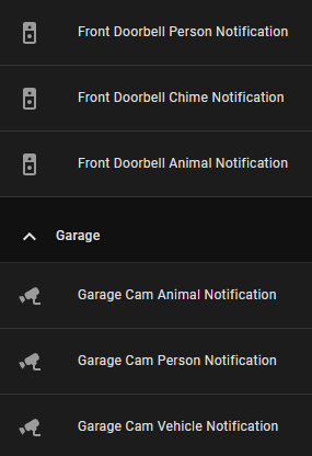

Do you have to set this automation up for each camera or can you do 1 automation that will just send whatever camera picks up the person from a list of cameras?
I’m pretty sure you can only set up 1 camera at a time and specifically only 1 type of event at a time. For example, I have a separate automation for each camera and each type of motion event I care about (Reolink cams).
Thank you. I’ll set it up that way.
