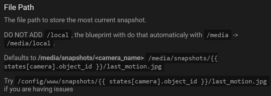

I’m trying to have have the automation also create a persistent notification in the web GUI as part of the ā€œAdditional Actions Afterā€. My attempts are unsuccessful. I just get a broken link icon. I have tried it with and without adding /local into the file path.
Am I missing something stupid?
action: persistent_notification.create
  message: Motion Detected in Storage Room at {{ now().strftime("%H:%M:%S on
   %d-%m-%Y") }}
   ![image-name](/media/local/snapshots/{{ states[camera].object_id }}/last_motion.jpg)
  title: Motion Detected in Storage Room
  notification_id: "1113"
no, some added actions break the blueprint. I do not know why…
