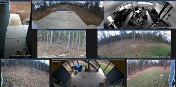

This is a custom:webrtc-camera card in HA fed from Blue Iris and can be viewed from external access as well.
