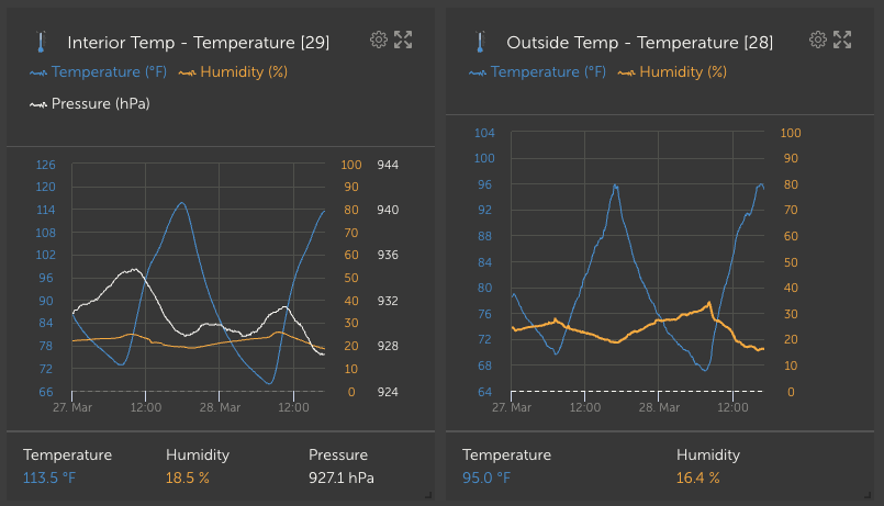

My concern is hardware to actually run HA on. I figured I’d support HA and just buy a green, but I’m really worried about interior temps of the van in the heat of the summer as the green states it can only handle up to 104f. Outside temps can reach 115 and interior can be a raging infurno. Does anyone have some suggestions on what hardware I can run HA on without issue in temps like this? Here is a screen grab from my temp sensors installed on the van: Outside temps today are in the mid 90s and interior is at 113.

I’m not about the camper life but I do have my HASS running in an extremely hot area in the summer time it’s easy to see the temp in the space at 110f. I’ve been running this was 3 years now. I’m using a raspberry pi 4b with a poe hat with fan on it and it’s using an external SSD for OS not a Micro SD. I do subscribe to Smarty Van on YouTube they covered server options pretty well a few weeks back https://youtu.be/v2MAdGnatO8?si=2FBPNZ5_goZawElG
