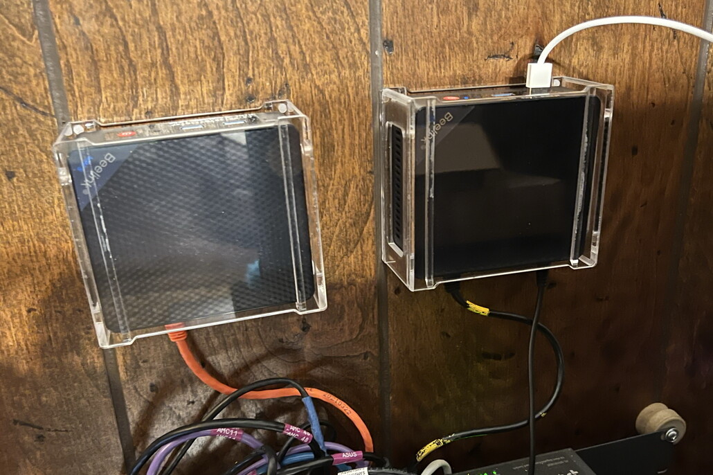

I have two identical BeeLink Mini-S. The one on the right runs HA (Ubuntu installed) for day to day Z-Wave and other normal uses.
The Beelink box on the left is presently virgin; I would like to use it to train myself and experiment (non-retribution), and make mistakes, and reformat/reinstall as needed.
Question becomes, and being mindful of same URL, and especially same port 8123, is there a way to put the 2nd one on a slightly different URL and port, so both can run in tandem? Or, will DHCP simply take care of the URL but not the port?
