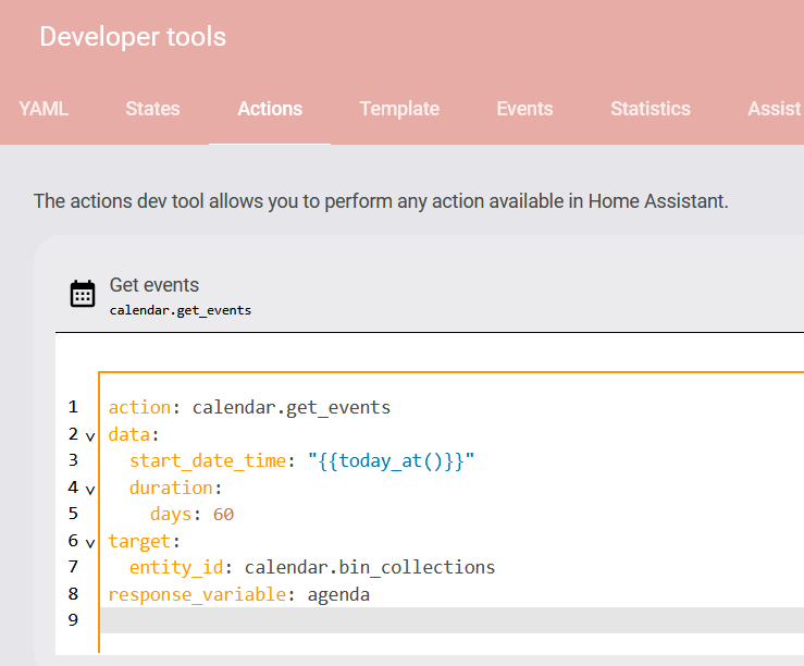

I can run the calendar.get_events action in Developer Tools:
and the response is the following:
calendar.bin_collections:
  events:
    - start: "2026-01-06"
      end: "2026-01-07"
      summary: Recycling bin collection
      description: ""
    - start: "2026-01-20"
      end: "2026-01-21"
      description: ""
This works correctly - in this case, there are two recycling bin collections within 60 days in my calendar, but NO garden bins, so that one is absent from the response.

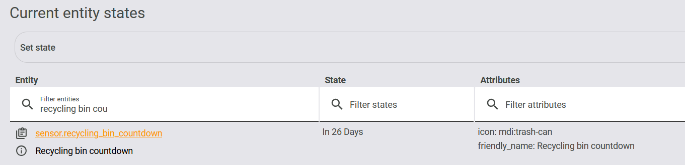

It works correctly when a bin has an upcoming collection:

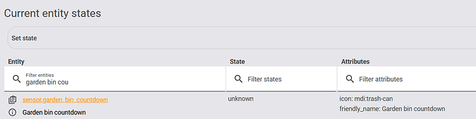

But fails when there is no upcoming collection, and gets the state “unknown” instead of “None upcoming”:
Anyone spot what’s going on here?
My feeling is that the logic is correct (because it’s returning -1 correctly in template editor), but it’s something to do with assigning variables in the YAML and then trying to use them in the trigger-based template sensor… Although it’s partly obtaining the variables correctly because I indeed obtain “In 26 Days” for my recycling bin…

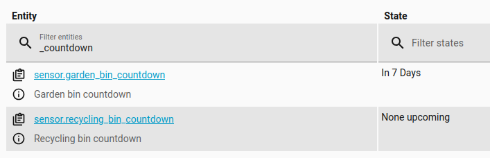

  • sensor.garden_bin_countdown initially reports In 7 days.
  • Added the startup trigger.
  • Reloaded Template entities.
  • Deleted the scheduled garden bin event from calendar.testing.
  • Restarted Home Assistant
  • sensor.garden_bin_countdown now reports None upcoming.
