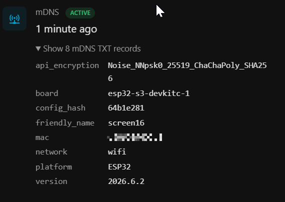

I’m pretty sure the ESPHome builder has this notion of “adoption” for devices found on the network (see esphome/esphome/zeroconf.py at f0800336b8e7decf4fecd78e53e034dc97676e64 · esphome/esphome · GitHub) through mDNS.
Now, I never expererienced it myself, as I never had an ESPHome device I didn’t create myself.
my best guess is Device Builder is using this to pair information from the device with the node created based on the existance of the YAML, using TXT-Records on mDNS
moved the yaml to a subfolder => doesn’t show anymore in device builder
restarted the device => works with HA, but isn’t seen in the device builder
move the yaml back => within seconds shown in the device builder with correct status
