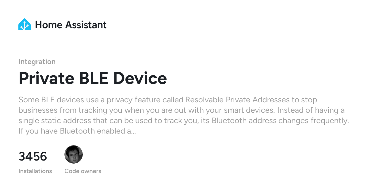

The private ble integration is your best bet, though some brands stop transmitting while asleep:
