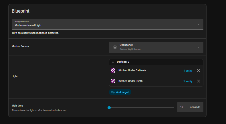

Can i add a sunrise/sunset to this automation?
Hi there...as above.....ive done a few basic automations but cant see where i can add a sunrise/sunset option to this motion activated light? - in that i just want the light sensor to swtich these lights on (and in turn they auto off) only when its dark...?
Thanks
We see a picture of a blueprint input screen.
Is this the built-in example blueprint or something else?

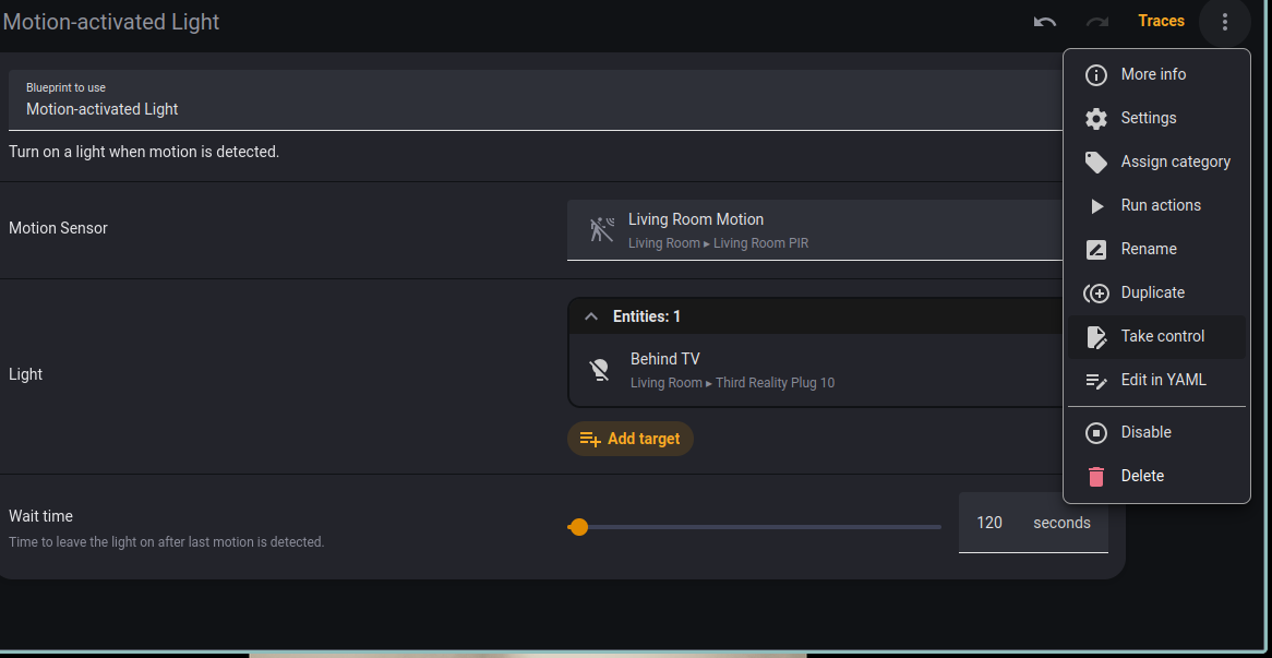

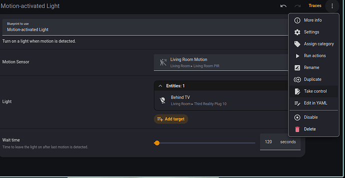

Fill in the fields, save the new automation based on the blueprint, then click the three dots in the top right and choose "Take Control"...
Now that you are in control, you can add any additional components that you want.
