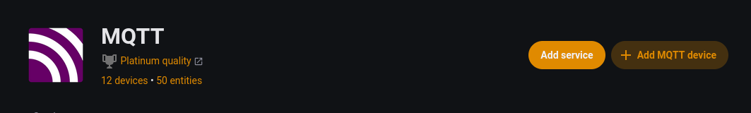

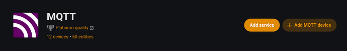

No, you can set up the integration in the UI by clicking the “Add Integration” button in the Integration dashboard then select MQTT.
If you have already set up the MQTT Integration, you go into it’s integration settings and click “Add MQTT Device”

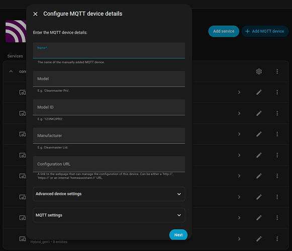

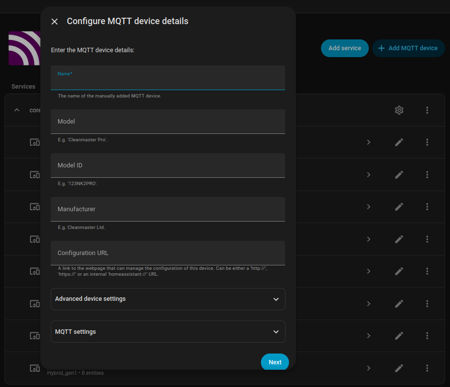

Like this?
How can I access my old devices to see how I did it last time?
None of these fields look familiar?
M.
It’s quite possible you’ve never seen them before because the devices were discovered automatically. If that is the case, I’m not sure you can see the config flow.
