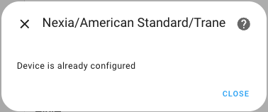

I set this up initially when it was Nexia. I transitioned to Trane when the company changed it from Nexia to Trane (I think). Both worked correctly. I believe that I removed the final integration via the UI.
There is no integration on my integrations page. I have no sensors or devices related to either.
Trying to add in the integration to get it going again, I get this:
I find two related files:
  • nexia_config_xxx.conf
  • trane_config_xxx.conf
where xxx is my user name.
There is also a line in the config > Storage > core.config_entries file.
I am thinking the files confuse Home Assistant and I should delete them.
I could also delete the line out of the core.config_entries file.
Are either of these changes safe? Is there some other way of getting rid of these
