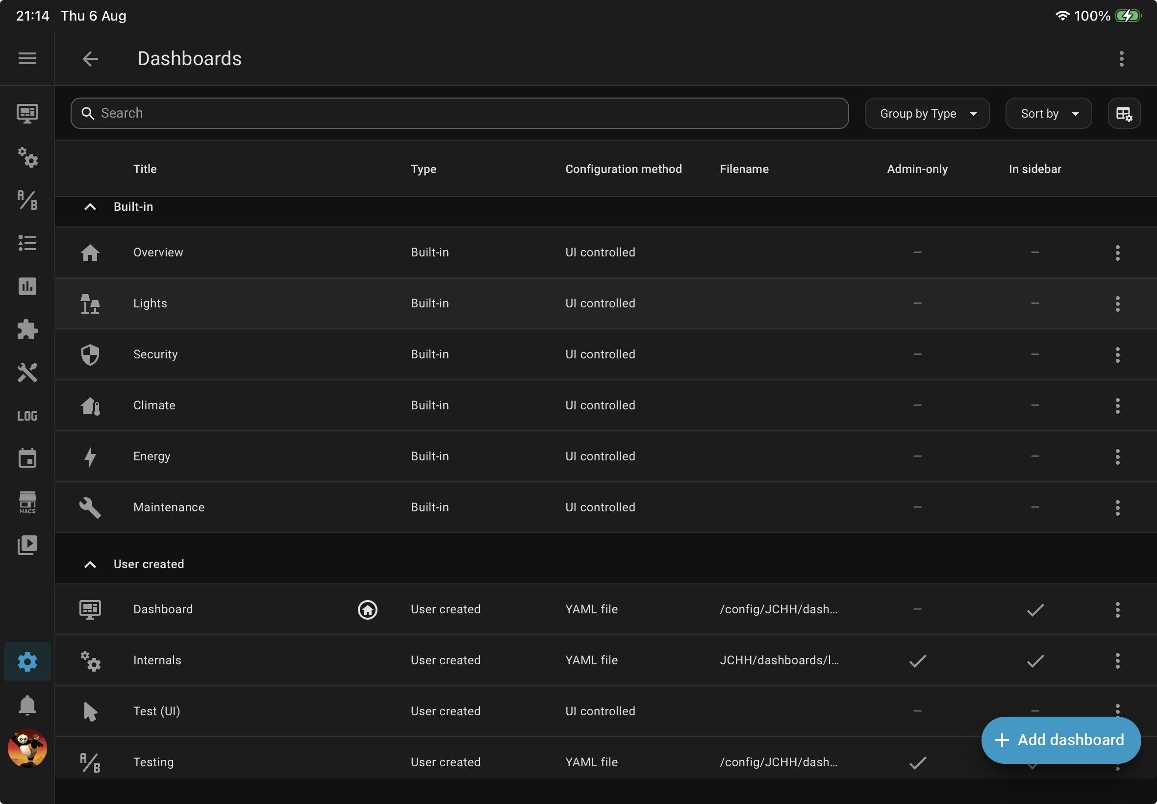

You can’t delete it, but you can hide it from the sidebar.
Go to settings → Dashboards → burger menu → edit → deselect “add to sidebar”.
Select a different dash as your default from the same burger menu.

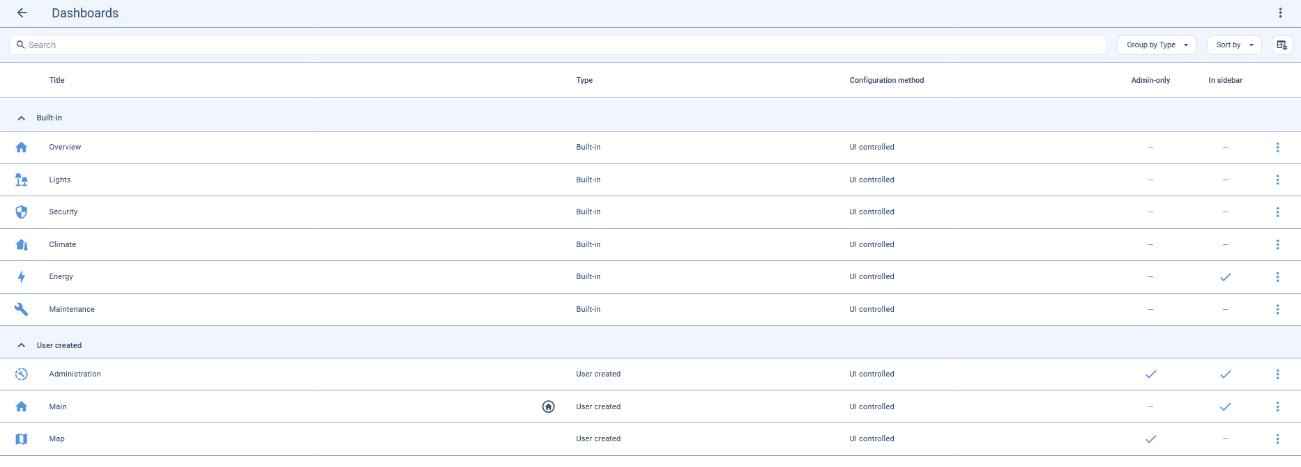

As others have said, no there isn’t. However hiding the unwanted junk and retaining your dashboard is easy:
  1. Go to Settings → Dashboards, rename your Overview dashboard to something else, like “Main”. Make sure it is still set as default.
  2. Update all your web browser bookmarks to use this new dashboard. Do not skip this step. It caused me no end of confusing issues recently when I was editing my dashboards.
  3. Update the system.
  4. Go to Settings → Dashboards and hide the unwanted built in dashboards (un-tick “in sidebar”).
  5. Done.
