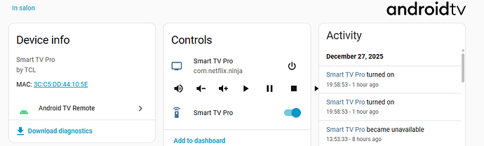

I connected a TCL TV (running Android TV), it popped up in HA and I configured the integration. I am now the proud owner of the following device:
This is not very exciting. Is there a way to control more things from that TV, such as “switch the TV on, start the France Radio app and select France Inter, set the sound level at 60%”.

The screenshot I provided with my question is from Android TV. Is there something else I missed in the list of exposed entities?
