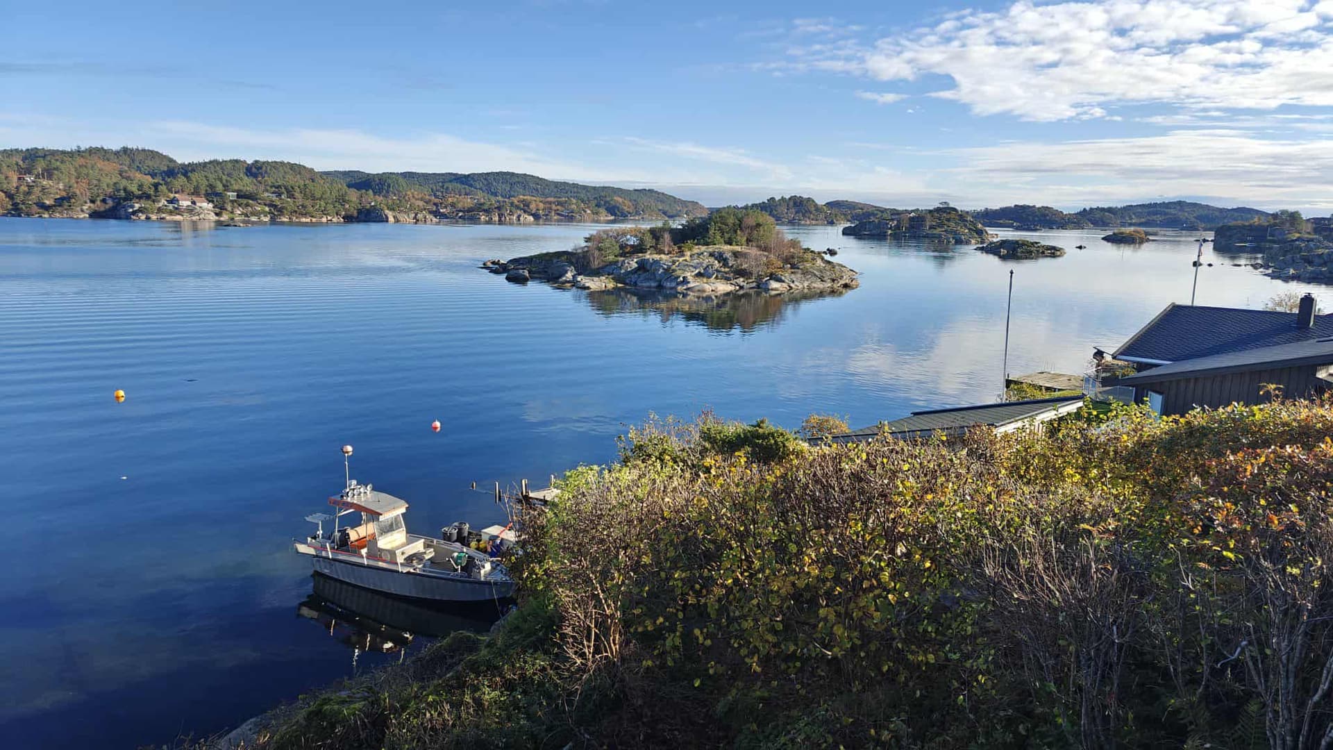

I’m very glad @LawrenceH’s solution worked, so I won’t have to use WPA1, but I do have to say that I wouldn’t be too afraid of using it here for what is in effect an IOT setup for my boat, the Mad Max:
Everything on the boat (Home Assistant, NodeRed, SignalK (boating software), GaladrielMap (sea map software), MQTT, VNC/SSH to the Pi’s, file sharing and so on) has strong passwords, and the boat is on it’s own subnet on my pfSense box, so it is possible to get to the boat from the cabin on the ports I have opened, but not possible to get from the boat to the cabin except for with MQTT-messages. I seriously doubt that there is even a script kiddie around, as long as the network is shown as protected I can’t imagine anybody trying to get in. :grinning:
Wow, that’s a nicely equipped boat. Great shot, BTW! The archipelago looks like it’s somewhere in Scandinavia.
Thank you! It’s called the Mad Max because it sort of looks like something from the movies with the equipment I have for setting crawfish, lobster, crab and fish traps. I am also going “Pacific” by mounting a Scotty downrigger that I ordered from Canada to do some trolling. Almost everything electrical on the boat is controlled by relays and ESP32’s. There is a box underneath the front of the roof with speakers in, the lid is controlled by an ESP32 and an actuator.
And yes, it’s the southern tip of Norway. If I go around the island where it’s docked on the north side, there’s nothing but sea and Denmark south of me. :grin:
