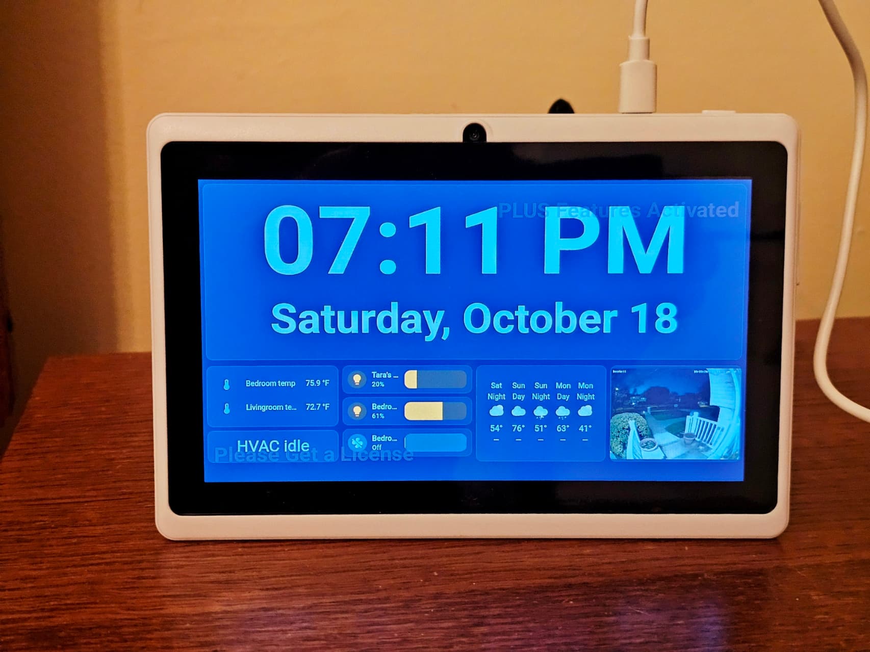

I am using a 7" tablet with Fully Kiosk to build a clock and control panel to use on my nightstand. I want to adjust the tablet’s brightness so that it dims when the room is dark. I was hoping that either the HA app or Fully Kiosk would have an illumination sensor, but I can’t find one.
