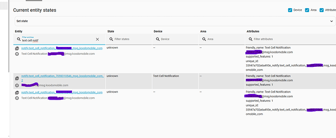

when i go check my smtp. intergration and my multiple numbers under seems ok
but in devices states, entity_id: notify.text_cell_notification doesnt exist
only
entity_id: notify.text_cell_notification_cellnumber_provider_name

comet424:
… but in devices states, entity_id: notify.text_cell_notification doesn’t exist
only
If you just want to change the entity ID of the notify entity, you can do that in the entity’s settings just like any other entity.

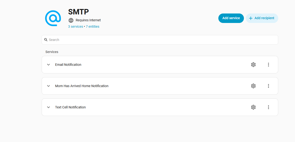

i did you saw it under STMP

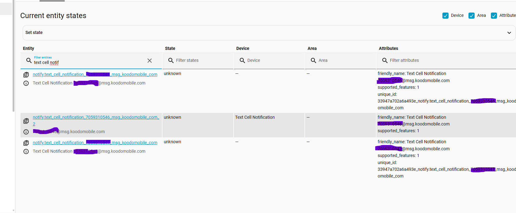

You showed 3 notify entities in the States tool screenshot, but none of them have the ID notify.text_cell_notification…

right there
3 notify entityss
with receipts under each one
so you send it to
notify.text_cell-notification
there is no
comet424

Those are not entities, those are integration service instances.
There should be a service instance for each email account you want to send from . Each service instance also needs one or more Recipients. Each Recipient creates a notify entity that can be used as a target for the actions notify.send_message and smtp.send_message.
