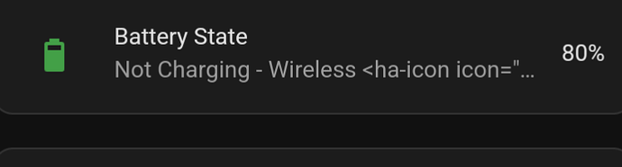

And if we aren’t using markdown cards? Standard templates don’t render this markdown
e.g.
<ha-icon icon="mdi:home-assistant"></ha-icon>
just displays as-is in the text field.

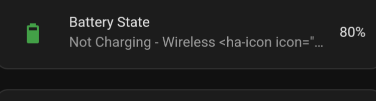

Here is the code in context (this is a custom row type which supports templating in all fields):
secondary: |
  {% set s = (states('sensor.pixel_8_battery_state')|replace('_',' ')|title)%}
  {% if s == 'Charging' or s == 'Not Charging' %}
  {{s}} - {{ states('sensor.pixel_8_charger_type')|title}}
  {% else %}
  {{s}}
  {% endif %}
And here is the result:
