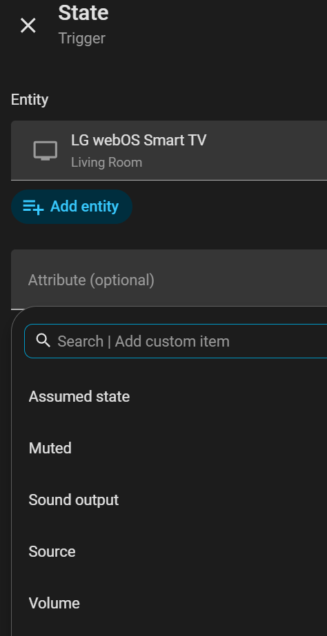

The TV needs to be on to get all the attributes populated in the automation dropdown.
Just checked on mine & the only attribute I saw while it was off was Assumed State. Turned on the TV & now I see all these:
Also, I suggest you follow the excellent provided by @LiQuid_cOOled above & add the not_from to exclude unknown & unavailable triggers. You'll have to switch to Yaml mode to do it, but it's quite straightforward to add those 3 lines.
