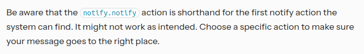

That’s from the template missing quotes, but the notify.notify action will not work that way. As the docs have warned for years…
Over the years, people in the community have shared lots of ways to address this issue.
