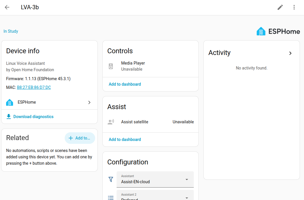

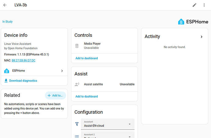

Looking in HA > Devices & Services > ESPHome (not the ESPHome Device Builder) you have listed your device listed, looking something like
Up in the top right corner is the pencil icon which lets you change the device name in HA (but doesn’t automagically change it in ESPHome Device Builder or your YAML file - another possible place for confusion) and its Area. Next to the pencil is a menu (shown by 3 vertical dots) which includes “Recreate entity IDs”.

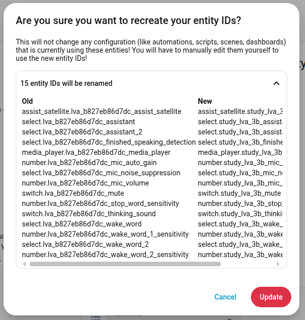

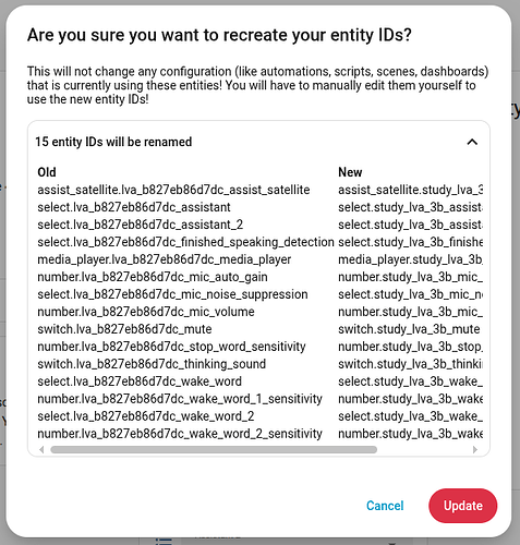

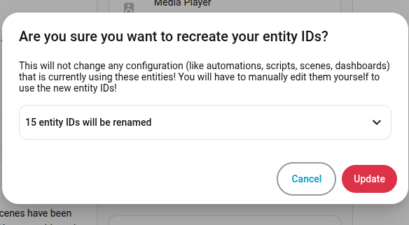

If you select “Recreate entity IDs” you will see a pop-up window which will probably tell you that some entity IDs will be renamed, and that some entity IDs will not be renamed.
Clicking on either will open the list so you can see them
In my example on the second line you will see
select.lva_b827eb86d7dc_assistant select.study_lva_3b_assistant
indicating that the “select” type entity named “assistant” was registered before I changed the device name from “lva-b827eb86d7dc” to “lva-3b”. If I click the [Update] button this entity will be renamed to the new device name “lva-3b” and have the area (“study”) also added to the entity_ID.
I THINK this is what you want to do - but check it out first.
