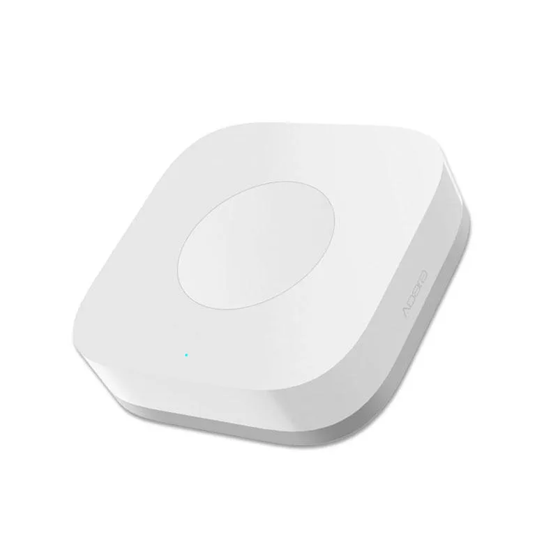

I have an Aqara mini switch in HA via the Hubitat Integration. When creating an automation I can only see button 1. Not sure if this is due to the Hubitat Integration. I tried one Aqara button blueprint and had no luck with that, so I thought I’d try it directly.
It only has one button.
How many did you expect to see?
Oh! I was expecting to see a button for each press. My dumb mistake.

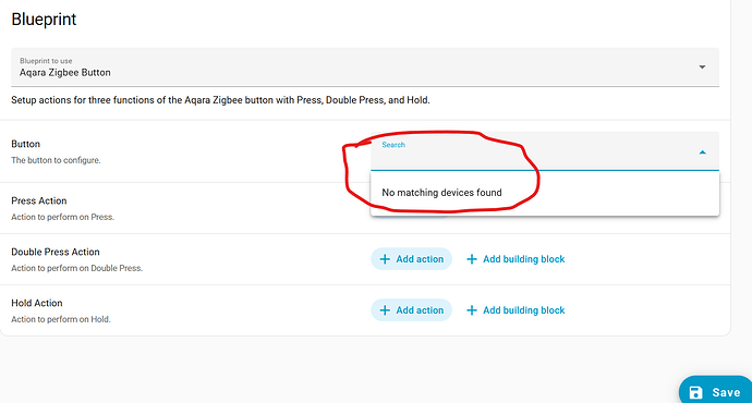

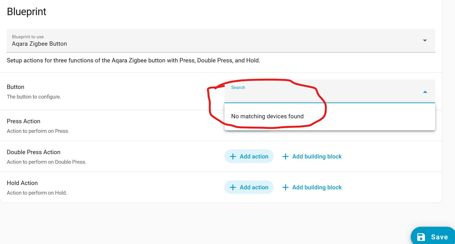

I tried the blueprint you suggested but it does not see ANY devices:
Keep in mind all of my devices are currently added to HA using the Hubitat Integration. So I’m somewhat skeptical of their functionality.
You’ll have to ask in the blueprint topic.
