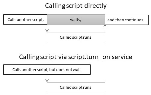

https://www.home-assistant.io/integrations/script/#waiting-for-a-script-to-complete
