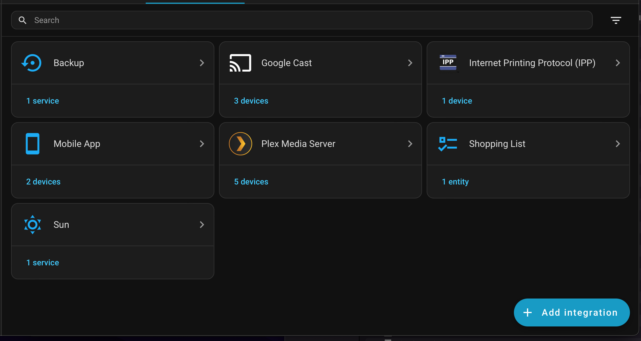

Did the installation pick up something and configured an integration?
Settings → Devices & services
i can’t see anything on there. maybe the backup?
What happens if you disable the ‘Google Cast’ integration?
I will try it now.
Or something related to Music Assistant.
I’m out of here: gotta go for a walk.
That’s what I’m after. So i cast to everything in the house. Thanks for your help. i should trouble shoot all the devices i guess.
Disabled all the devices. Still no luck.
It’s not due to a device but your HA and TBH I don’t know what it is related to exactly either.
I guess you know what streaming is and this seems to be caused by something that you have configured to stream multimedia (audio/video).

  3. Also, when you said the config flow could not be loaded… what config flow exactly? From the screenshot I see you have a system running already, wouldn’t that means you have finished the initial setup config flow??
