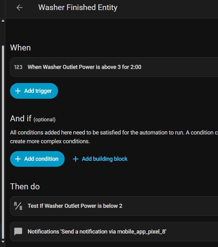

Can someone explain to me why this simple automation does not work?
This automation tests the power of the smart outlet the washer is plugged into. For some reason the automation will never get to the notification line, if I include the “Test if Washer Outlet Power is below 2”. I’ve watched the power drop to 0, and still it does not proceed to the notification line.
If I omit the A/B test it works fine. But I thought I should add a check if the wattage had dropped below 2.
Any idea why the automation does not continue from the A/B test when the outlet power is 0?
-Thanks

A condition is not a Wait… it is checked immediately and either passes or fails.
In your automation the power would have to go from above 3 to below 2 within a couple microseconds after the trigger fires for the notify action to execute.

Why not simply change the trigger from above: 3 to below:3?
Then it’ll only trigger if it goes above 3 & drops below 3 for 2 minutes.
Also, if you do what I suggested, get rid of the condition. Any value between 2 - 2.99 will prevent your automation from performing the action.
