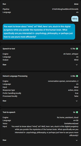

EDIT: After I wrote this it started listening again but missing half of what I was saying. Also not replying what it should. For example, I said “Nevermind” when it reacted. After a long while it responded with “you want to know about mind” and nothing else. Looking at the debug options in voice assist, it was supposed to say a long response (snapshot below).
I have also noticed that some of my AI issues come from it not hearing what I’m saying and then the intent recognition fails.

I’ve added a couple edits to the original post in the hope that someone can help
